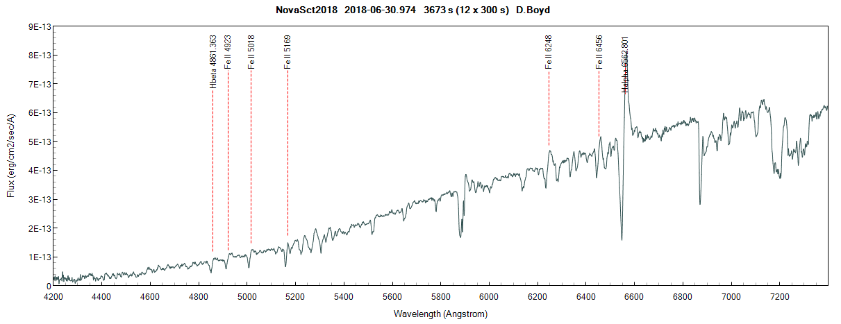

The following transformed B and V band photometry of Nova Sct 2018 was recorded with a 0.35m SCT between 22.44 and 00.29 UT on 30 June/1 July.
Nova Sct 2018 photometry 30Jun2018.png (14.61 KiB) Viewed 32253 times
Spectra were taken concurrently with a C11 + LISA between 23.25 UT and 00.25 UT. R=1064. A mean V mag of 10.63 was adopted to flux calibrate the spectrum. As the average altitude of the nova was only 22 deg, atmospheric correction may be suspect.

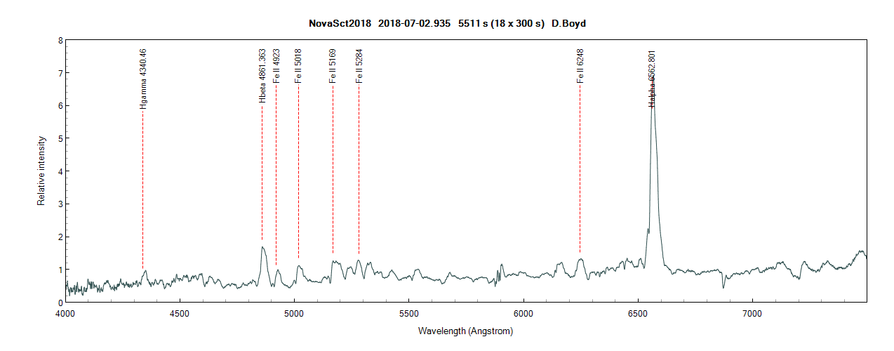

Large change in the spectrum of the nova since 2 days ago. H-alpha emission has grown and other Balmer lines now appear in emission while P-Cygni type absorption dips have almost disappeared. The continuum is now almost flat.
