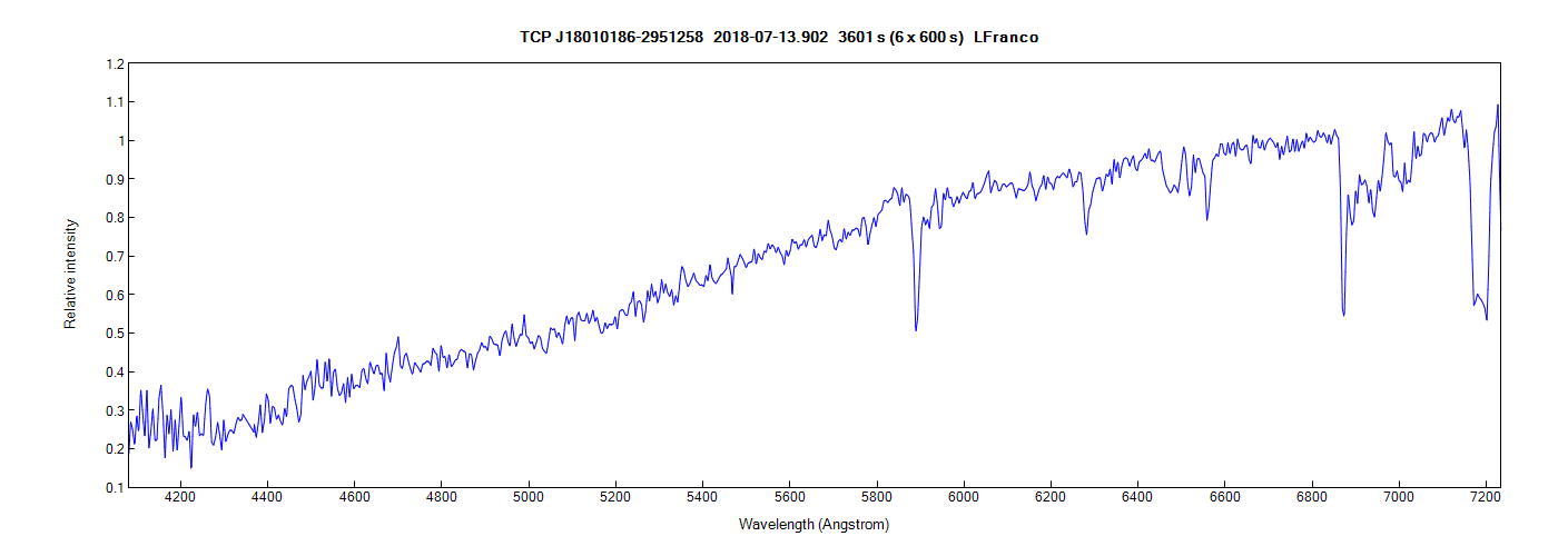

Christian and I made a spectrum of this target last night at the OHP during the annual spectro party and the spectra we got is visible here:
https://www.aavso.org/tcp-j18010186-295 ... agittarius
Very strange spectrum and at this date no confirmation about this kind of object.
Could be either a microlensing event and highly obscured supernova in milky Way (according to discussion in Facebook cataclysmic variables forum :

Really ?? This would be extraordinary if it turns out to be true. Any neutrinos seen ? (Facebook is a place I avoid)Olivier GARDE wrote:New CBAT about this object :
It is too low for me but definitely sounds like one to watch

Lorenzo Franco also got a spectrum of the event

I spoke to Subo Dong last night and pointed him to the spectra. (I sometimes work with him and the ASASSN team on supernovae) Even if it turns out to be a microlensing event, the question still remains what type of star is this ? Subo does not think this is a CV. What does the spectrum look like with the Telluric and IS lines removed? Assuming it is a hot star with very high extinction, what objects have a narrow H alpha in absorption and no other obvious stellar features ?

I wonder if lines are conserved through the deviation of the light by the lens object. I suppose it is not apochromacticAssuming it is a hot star with very high extinction, what objects have a narrow H alpha in absorption and no other obvious stellar features ?

Hi Francois,
I think the lensing effect itself is achromatic (all wavelengths deflected equally) but there are some reports of chromaticity in lensing, perhaps caused by different extinction in different paths or because emission at different wavelengths come from different locations in lensed extended sources. I think in general though the spectrum should survive the lensing. It did here for example.
http://www.threehillsobservatory.co.uk/ ... tra_30.htm
The Atel #11883 proposing that the deviations from the binary/extended source lensing model are due to pulsations of a red giant is strange. Pulsations might be a good explanation but surely the spectrum rules out this being a red giant (no molecular lines) ?
