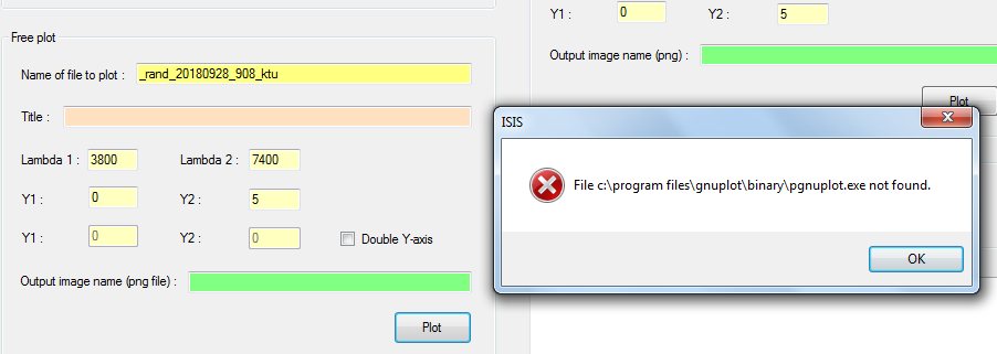

Hi!
I installed gnuplot,(+ Script files: std.gnu,std2.gnu and std2y.gnu).
I tried drawing a graph, not working. Gnuplot bin folder not included
pgnuplot.exe. Where to get it?
Pgnuplot.exe not found?
- No pgnuplot.png (33.61 KiB) Viewed 8552 times

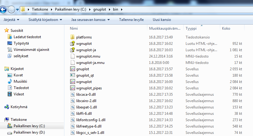

Pgplot likes to be installed in the root directory ie C:\pgplot
I could not get it to work anywhere else.

Re: Pgnuplot.exe not found?
Thanks Terry, it did't help pgnuplot.exe is still missing.
Timo
Timo
- No pgnuplot.png (85.77 KiB) Viewed 8538 times

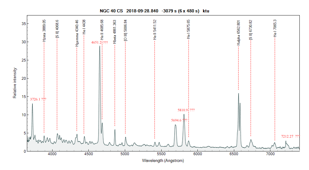

Hi Timo,
I cannot help with your problem, but as an alternative have you tried Tim Lester's plotspectra for plotting ?
http://www.spectro-aras.com/forum/viewt ... 596&p=7361
You can find a link to the latest version here
http://www.spectro-aras.com/forum/viewt ... 25&p=10162

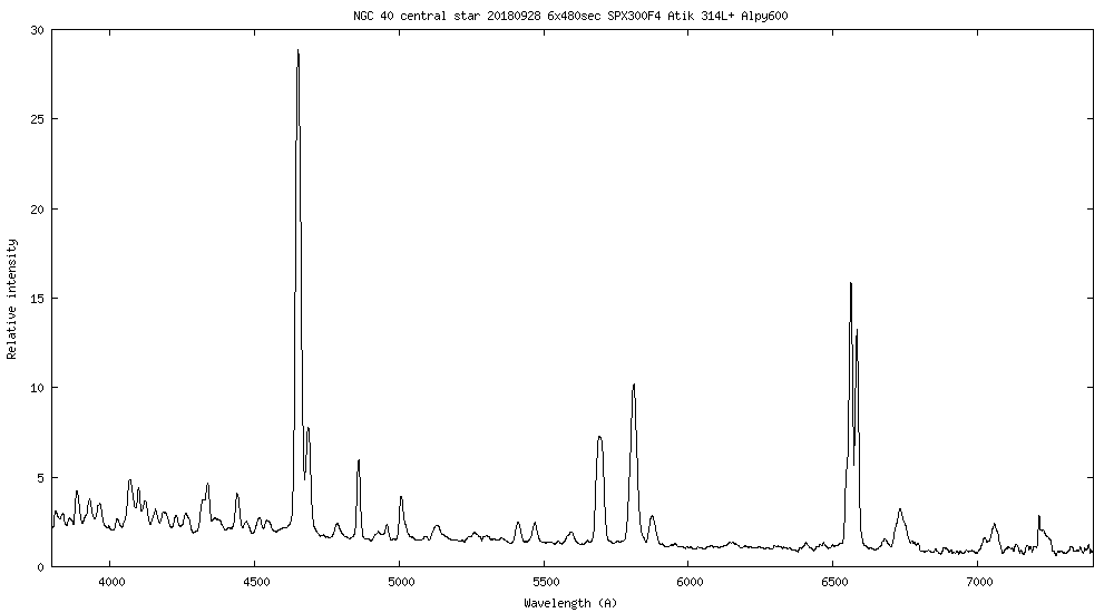

Hi Timo,
You have to upload an old version of Gnuplot (V4.4.6 for exemple) but not the last version V5.
It's necessary to use a V4 version of Gnuplot to work well with ISIS
Timo Kantola
- Posts: 14
- Joined: Tue Jul 17, 2018 4:13 pm
Thank you Robin!
Plotspectra seems good especially detection and marking of spectral lines (it would been the next question - how to name the spectral lines)
Merci Olivier!
Gnuplot V4.4.4 works well !
Merci Olivier!
- NGC 40 central star_20180928_840_ktu Plot.png (7.01 KiB) Viewed 8498 times
