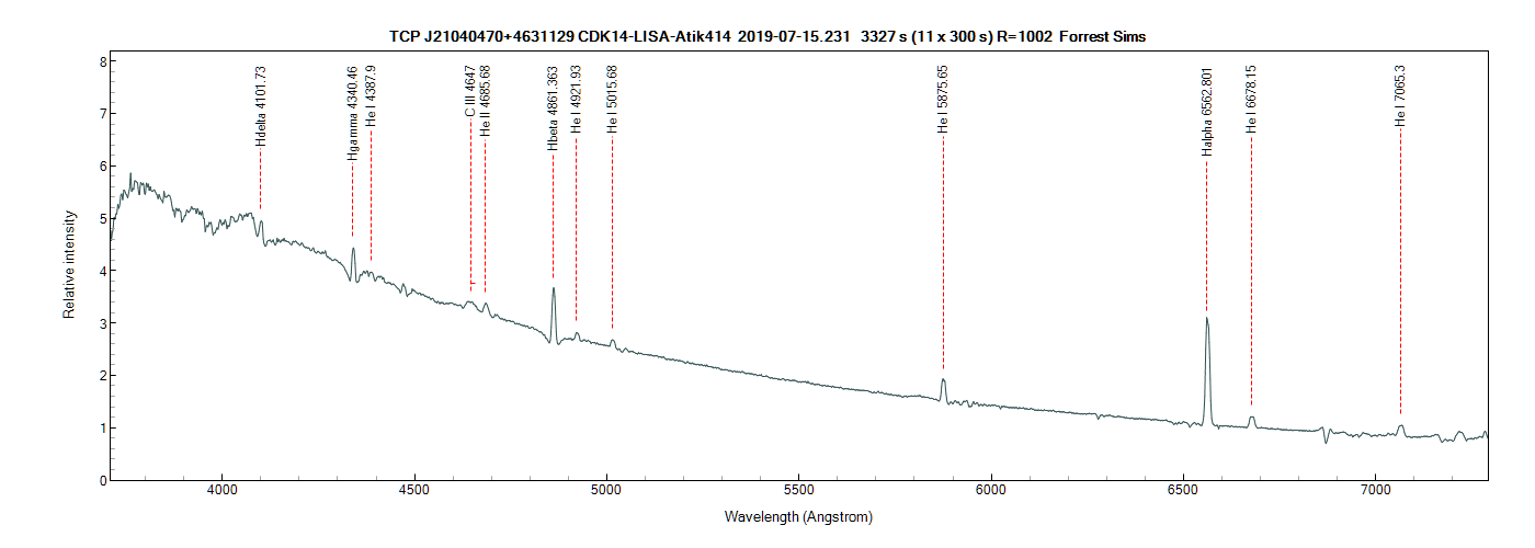

And my contribution on TCP J21040470+4631129 taken with my LISA late evening 2019-07-14.
Woody
