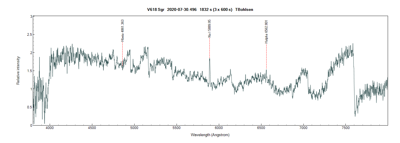

I have taken spectra of EC19249-7343 and V618 Sgr.
V618 Sgr seems to have NaI emission and a very weak Ha emission.
Terry.
Terry.
