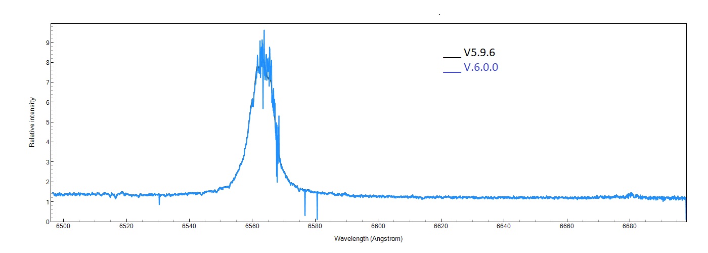

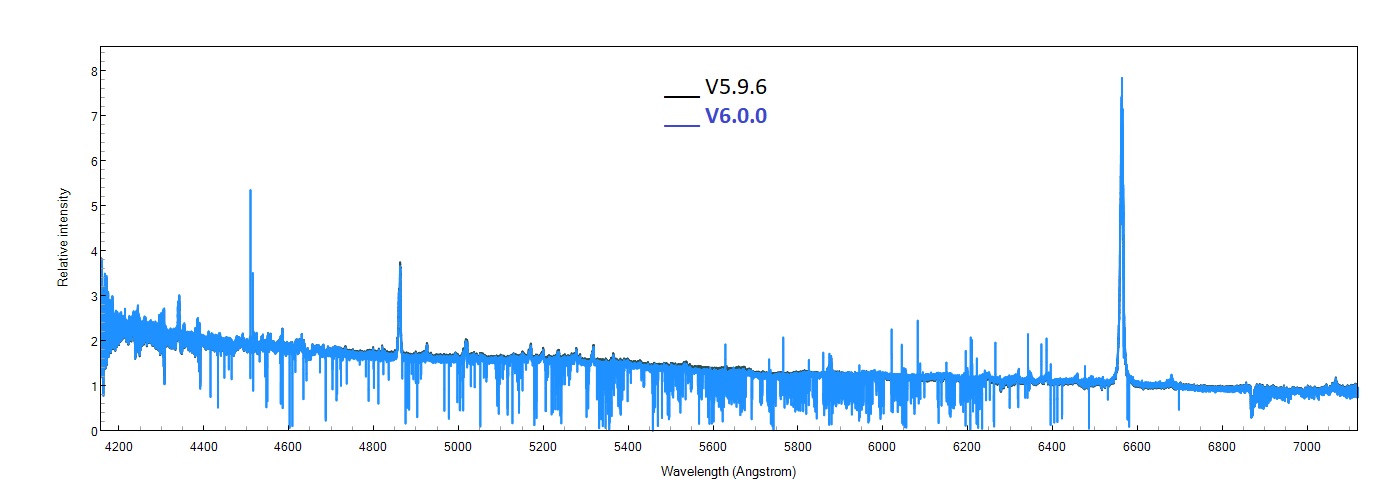

I believe there is a bug in V6.0.0 affecting eShel spectra.
Using the same data and parameters the final spectra produced by V6.0.0. have many absorption spikes which are not present in V5.9.6 or earlier versions.
See attached example.
I have not check if a similar problem exists when reducing single order spectra.

Look the eShel setting panel and adjust the Rejection coefficient to 100 (at the Botton of the panel, "Optimal extraction" section). Try also a zero value gain.

Christian,
Thanks for your suggestion to change the Rejection Coefficient to 1000 as this did work. I also tested with the value 10, which also worked, compared to the original value 3 which did not work.
I am puzzled about what has changed between version 5.9.6 and 6.0.0 as the rejection coefficient=3 works with the earlier version but not with 6.0.0 (both using same data and xml files).
Bernard
