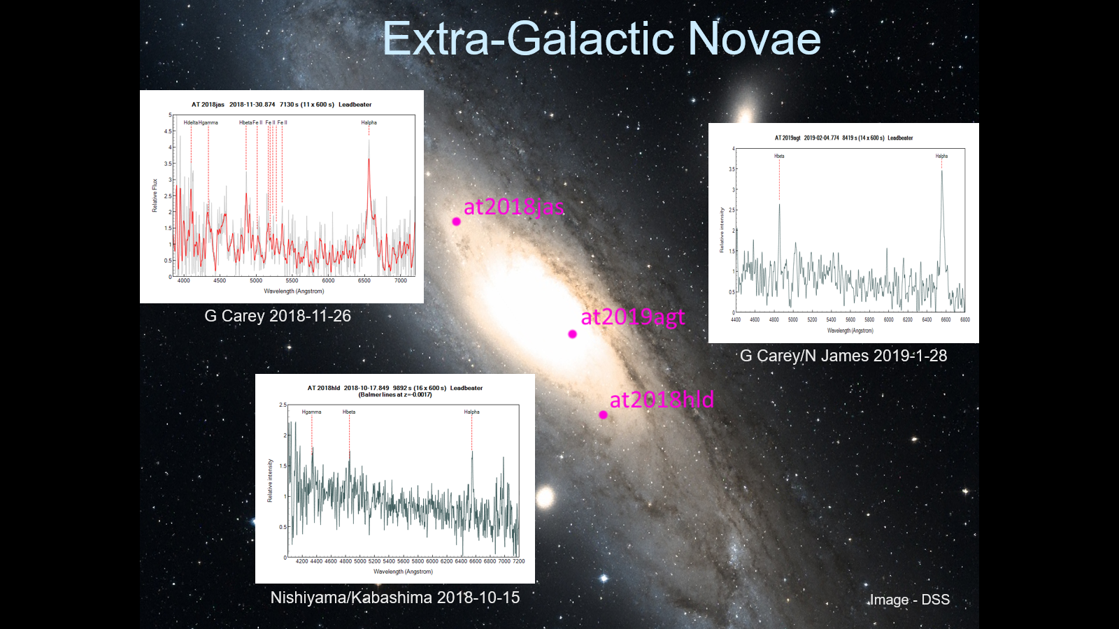

it is quite bright for a nova in M31 though and it does not show any nova features in the spectrum yet so it will definitely be interesting to try to take more spectra. It could perhaps even be a foreground dwarf nova. Has anyone looked in images for a precursor? (probably difficult because of the brightness of M31 background)
Here are a few M31 nova spectra with the ALPY 600
