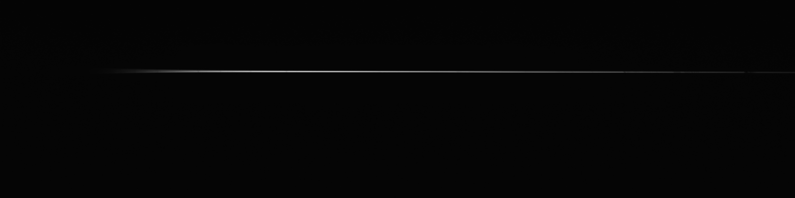

At last a night of good weather let me have a few shots with my new LISA.
Here is attached an spectrum of Alnitak, not calibrated with flats or darks. I am having a question here.
Are the spectrum endings at the picture normal? I mean, it looks like the spectrum spreads out, it is wider, at the left end. And at the right end, it is divided in two lines.
Thanks for comments.

Hola David,
Lo primero que veo es de que está sumamente sobreexpuesta tu imagen. Así como lo veo es un problema de enfoque.
Se puede analizar mejor si le bajas la exposición para ver como se ve bien expuesta y así tener más información y poder darte algunos consejos.

First of all, the spectrum is not well focused, we can see it because the spectrum is doubled. It's also over exposed and not horizontal.
For the blue part which goes in "fish tail" it is normal because there must be in your optical chain of your setup a focal reducer or other lens which is not achromatic

Thanks for all your comments.
I will work on the focusing. I will try Demetra for that, i intalled and tried it already. I used to acquire and reduce a few spectrums but i did not try its focusing tool yet. I did not find anything about it in the Demetra manual, by the way. Or i missed it!
Regarding the fish tail in the blue part, you guessed it. I have a .5x Optec reducer ahead of the LISA. So i suppose it explains it.
On saturation, i am not sure. You say that the spectrum is saturated, but the maximum point value in the raw FITS image is around 24,000 ADU. Saturation in my Atik 460 EX starts around 50,000 ADUs, if i am not wrong. Why do you think it is saturated?

Hi,David Cejudo wrote:Thanks for all your comments.
Possibly you did stretch wrong the image when converting to JPG.

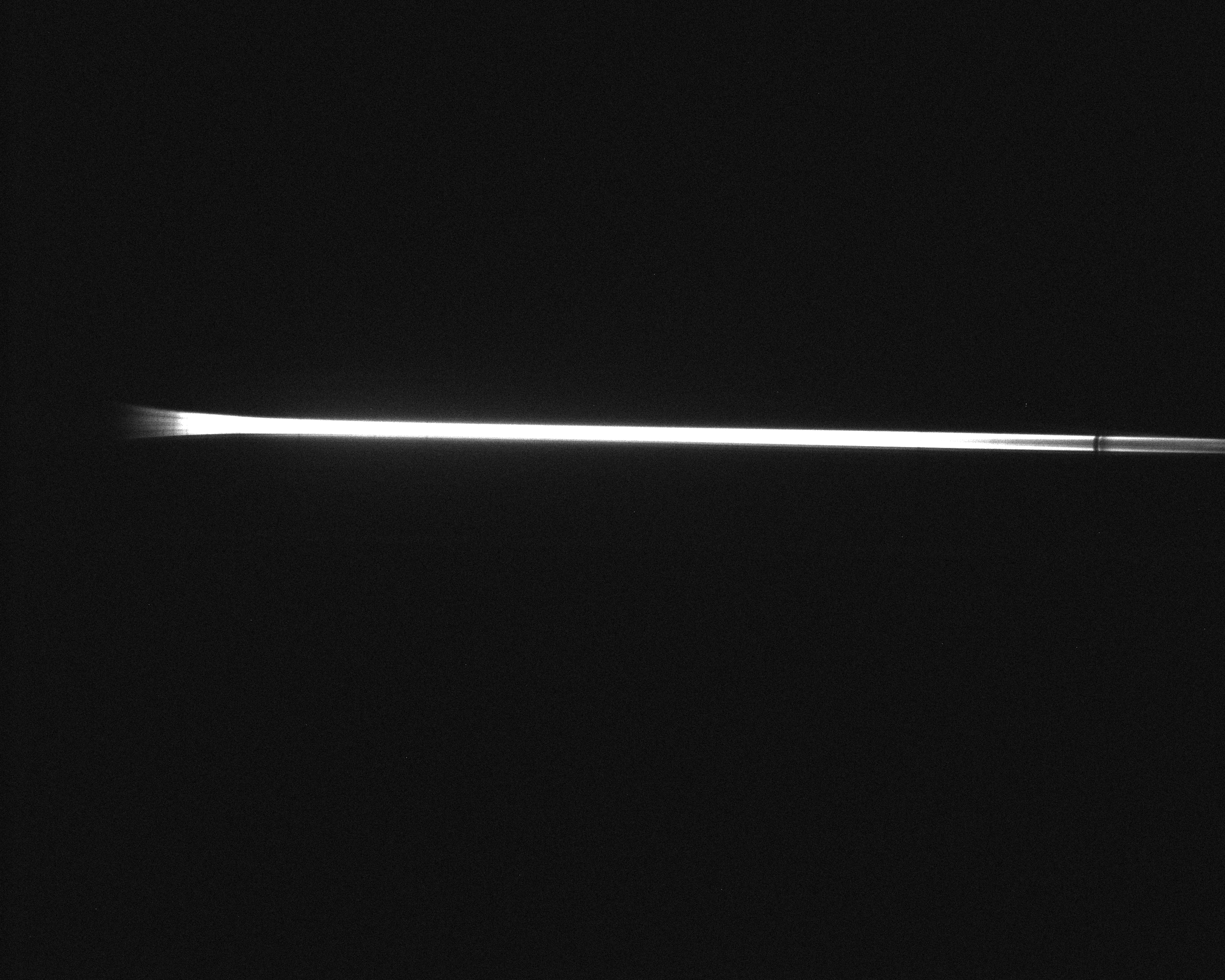

I also have a Optec reducer 0.6X in front of my LISA and my spectra look like this on the blue end.
Alnitak is a very bright star and the highest Luminance is on the blue side and perhaps that makes it also worse. Below a spectrum from me on ALnitak and my exposure time is only 0.5s but I am binning 3X in the vertical and 1X in the horizontal.
I always check my focus point on my guiding image and adjust it there. In order that this fits and I guess you did it is well explained in the LISA manual, page 14 ff. What is your native focal length ? You did not say what telescope you are using and if you guide or not using the guide port of the LISA.
This is how Alnitak looks in my LISA setup. Will need to make a test with Binning 1X and 1Y and compare results.
