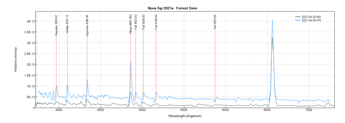

Re: Nova Sgr 2021 (a)
Here is an update on Nova Sgr 2021a from last night. The plot includes my prior observation from 2021-04-08 for comparison. Both spectra are flux calibrated which explains the offset in the graph. I recorded the V magnitude at 11.18 last night and the previous 2021-04-08 observation had it at V mag 9.80.
I think I have correctly identified the FeII [42] triplet lines?
Woody
Woody

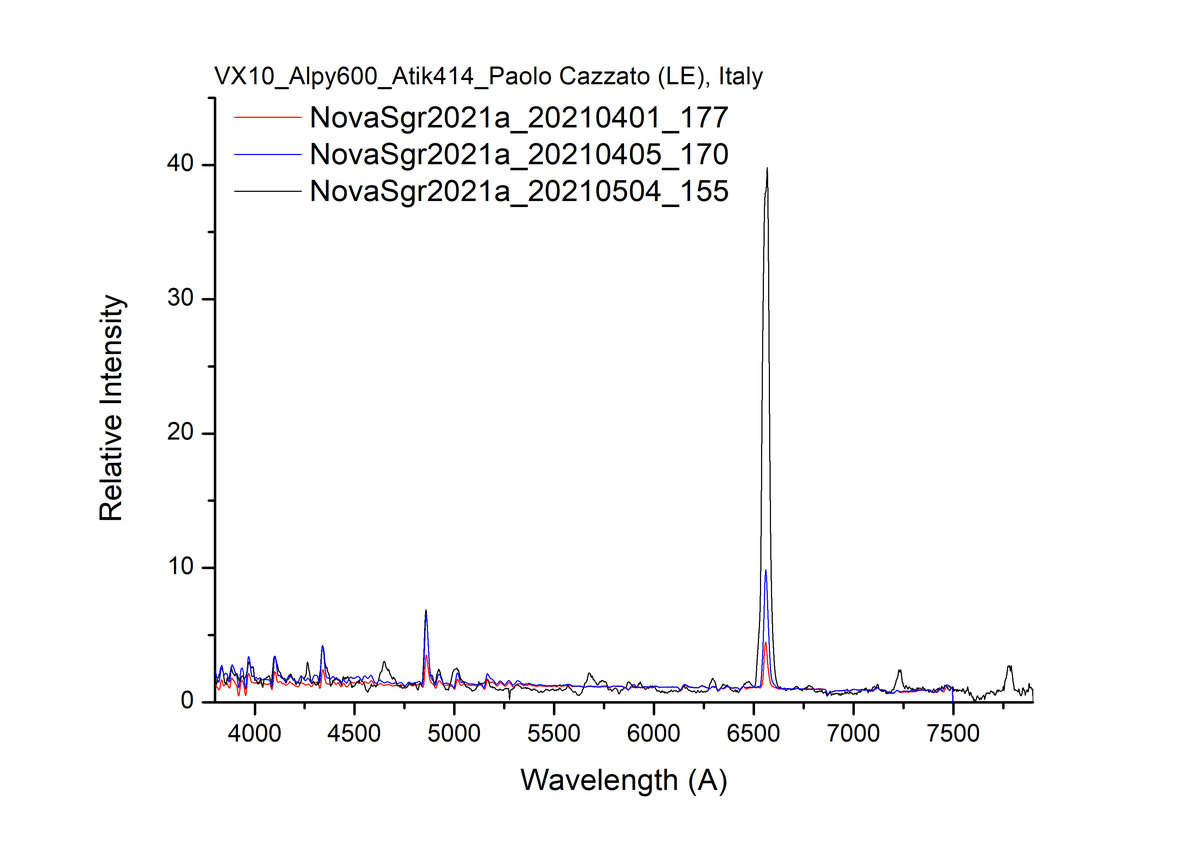

Hallo everybody,
here my simply comparison at low resolution made using alpy600 not flux calibratied. I can see an evolution in the spectrum noting an incresing of expansion gas from around 900km/s to 1600 km/s. It would be very interesting to continue acquiring spectra to evaluate the evolution but unfortunately in my location from now on it will be more difficult to take spectra in Sagittarius since the sun rise early.
