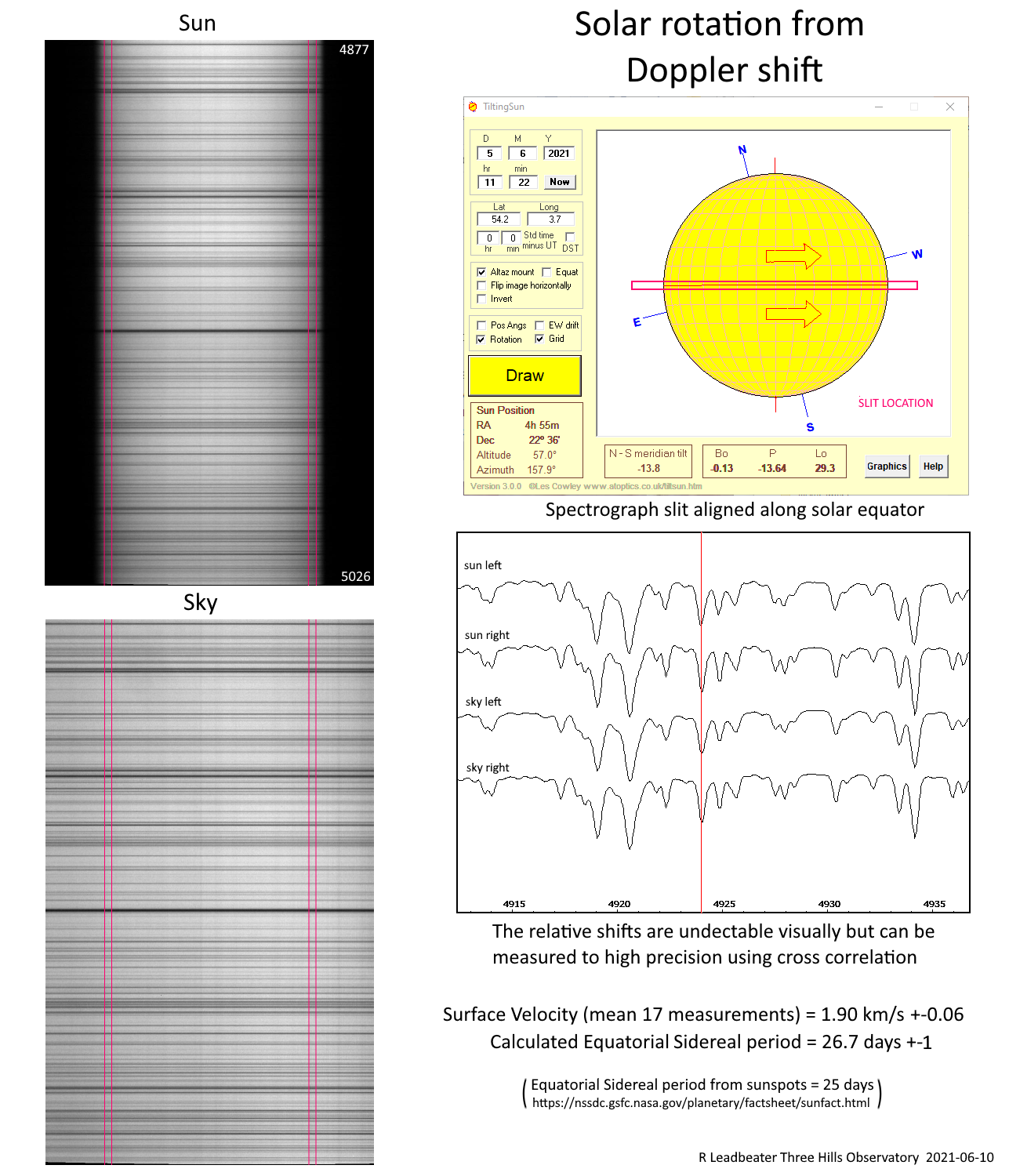

Just a bit of summer fun while there was no dark nights here.  A measurement of  the radial velocity of the Sun's surface to 60 m/s precision with a LHIRES. Details here on my BAA page
https://britastro.org/observations/obse ... c3d49944e0
							60 m/s radial velocity precision with a LHIRES
