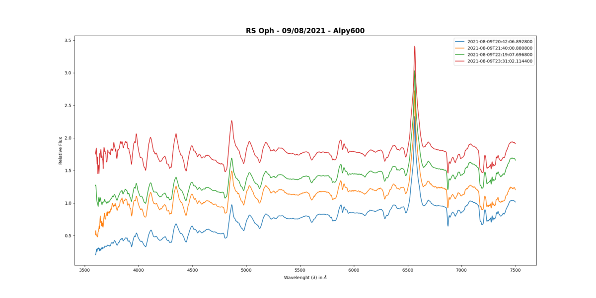

Here is a spectrum of the outburst taken tonight, 9th August, with a LISA. Very sharply peaked H-alpha line with FWZI of about 7000 km/s. Other Balmer lines similarly broad. I don't remember seeing a spectrum quite like this before!
Here's one of the 4 spectra taken this night with an eShel spectrograph R=11000
The full spectrum
And H Alpha velocity graph

Posts: 1559
Yes
The two main guidelines
to understand the formation of Balmer lines:
1. It is a recurrent nova,thus the white dwarf is massive, near Chandrasekar limit: a faint amount of accreted matter is sufficient to produce a nova outburst and the velocity of the ejecta is very high (not far from a SN!): this is the main broad component of HI lines.
2. The nova event appears in a symbiotic system with a high density nebula produced by the wind of the red giant (velocity of ~ few 10 km/s). The nebula, partially ionized in "quiescent" state, is strongly ionized by the nova phenomenon and recombines: this forms the narrow component.
See also V3890 Sgr as another example: https://aras-database.github.io/database/v3890sgr.html
Bonnes observations!
