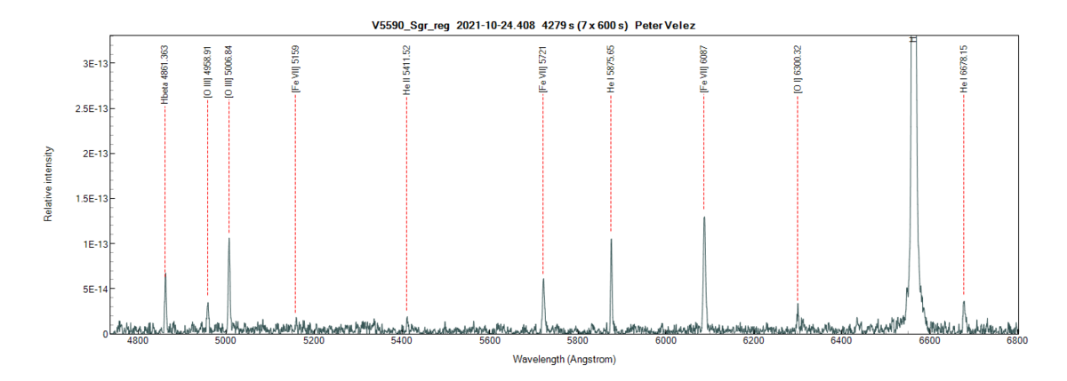

V5590 Sgr looks like a symbiotic.
I attach a 70 minute spectrum taken with the UVEX on a PW CDK 12.5. Resolution is reported by ISIS at 1426. SNR for the continuum is very low but the emissions are quite obvious. My measurement of V mag is 14.63 with an error of 0.09 mag. This is worth redoing. The spectrum has been flux calibrated.
My UVEX needs time to cool down and because the roof opening was delayed last night, I didn't get the necessary cool down time. I have manually shifted the spectrum by 4.5 A based on the Ha and Hb lines. I used the wavelength calibration tool in ISIS and assessed the drift in temperature for the target images as well as earlier Are frames. The shift in calibration is quite linear and the line of best fit reconciles with an adjustment of about 4.5A so I'm happy with this.
I've marked the key emissions that I have identified - as always, I will accept any comments/corrections. Ha and Hb are obvious as are [OIII] and HeII. [FeVII] at 5721 and 6087 are also substantial.
This target is worth another look. I plan to try again later in the week.
Spectrum to be sent to Francois for the database
Pete

Hi Pete
You have observed this before on 4/10/20 and it seems very similar.
https://aras-database.github.io/databas ... 04_433.png
Terry

Oh dear. That is embarrassing!
Mind you, I struggle to remember what I did last week.
At least it is consistent with last year’s observation.
Thanks for letting me know
Pete

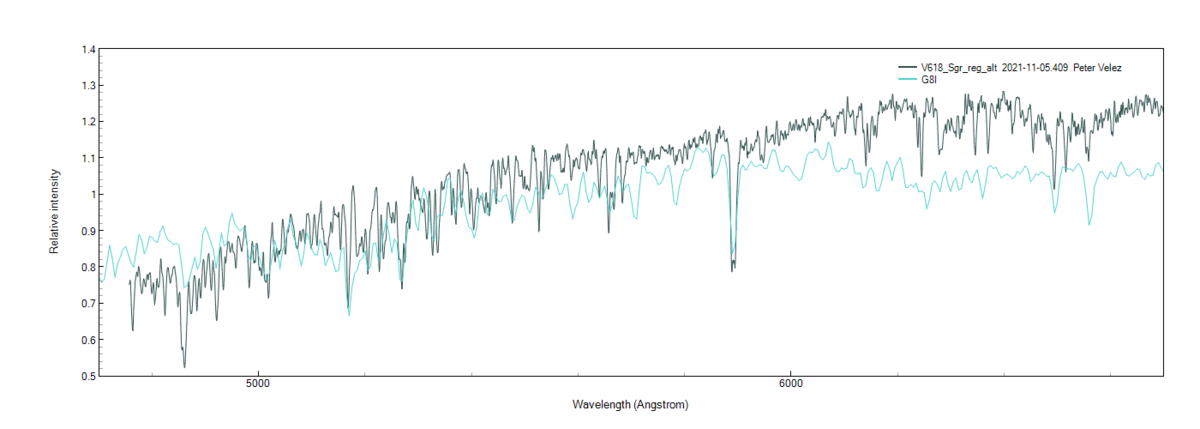

V618 Sgr (Peter) - I am bit confused. The target was observed also last year by Terry. The new spectrum is very different from the previous one. I am not sure if the correct target was observed both times. This object would require attention, probably next season.
V5590 Sgr (Peter) - symbiotic star, very strong [Fe VII] in the spectrum. Peter, this is not anyhow embarrassing, that you reobserved the target, actually, this was great that you did it! [Fe VII] lines in your spectrum from last year were rather weak, so only the spectrum obtained now undoubtedly confirms symbiotic nature.

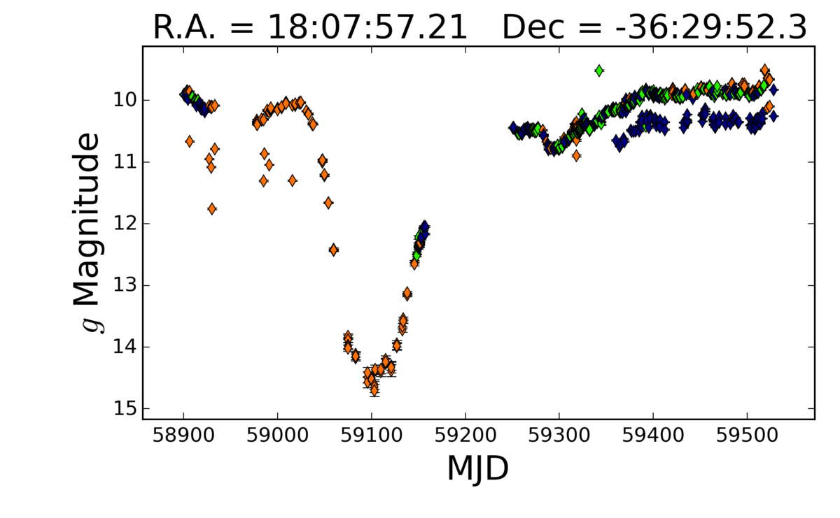

You mentioned in your request last year that the star may be brighter than ~15.3. It certainly was. I measured its V mag at around 9.3. ASAS-SN reported its g mag at between 9.65 and 10.0 on the same day so we are in the ball park. When Terry took his spectrum last year, the ASAS-SN g mag was around 12.4. I attach the ASAS-SN light curve for the last 2 years.
Simbad records V618 Sgr as a R CrB star - the dip in brightness and subsequent climb in the lightcurve is consistent with that. Terry's spectrum was taken as the star had not yet hit its minimum brightness while my spectrum was taken as it was nearing its normal brightness. There are no emissions. I've had a stab at identifying the absorption lines in the attached plot. If you disregard the continuum, the closest analog I could find was a late G star - again consistent with the R CrB identification which generally presents as an F or G supergiant.
The continuum is a distracting element of my spectrum. It was taken late in the season. I managed 2 exposures of 10 minutes with the target at airmass 2.6 at the beginning of the run. The reference star was a bit higher at airmass 2.3. Clearly there is atmospheric differential refraction at work here. I attach a plot comparing this spectrum to a MILES G8I star and its a reasonable match but for the dodgy continuum.
Please feel free to correct or comment. Irrespective of whether this hypothesis is correct, it will certainly on my list of targets for next year when it returns to the night sky.
Pete
