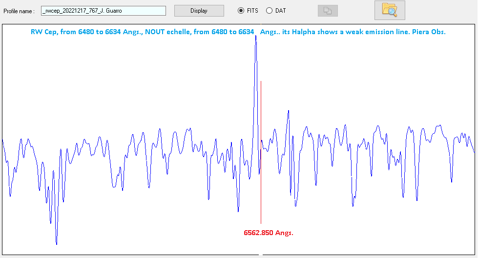

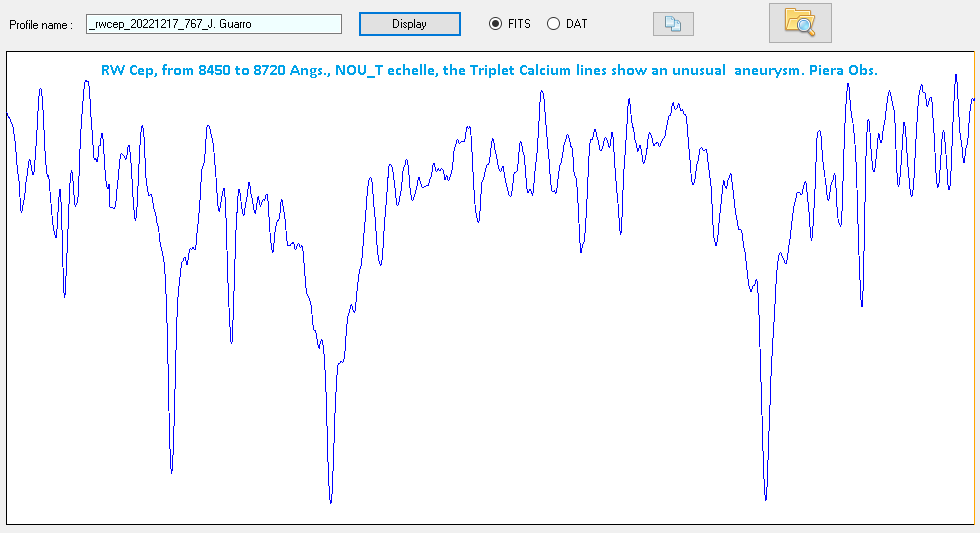

Hi Robin and everyone,
That is the result of one RW Cep observation, unfortunately the bad weather didn't leave me any other oportunity to observe it.
I left this in BAA, but I don't know either if exist someone interested in more observatons..
Merry Christmas and Happy Good Year, Joan.
- RW CEP 1.png (17.38 KiB) Viewed 28632 times
- RW CEP-2.png (14.3 KiB) Viewed 28632 times
- RW CEP-3.png (13.89 KiB) Viewed 28632 times
- RW CEP-4.png (25.9 KiB) Viewed 28632 times

Hi joan,
What do you think of the flux calibration of your spectrum ? Is it ok? What did you use as reference star?
The continuum shape is very different from mine and historic spectra in the EOODIE Archive.
https://britastro.org/specdb/data_graph ... 20+Spectra

Re: RW Cep unusual dimming
Hi Robin,
As you said, the perfect spectrograph doesn't exist, and I'm afraid that an echelle isn't the best tool
for taking a good calibration flux, in my opinion, using a low resolution spectrograph takes very useful
data for it and more easily.
One can see that almost all studies using echelles, represent their data in a horizontal background.
BTW, it's possible that I'll have a good night today and I'll try to take this star again, and go to essay
V photometry with the Piera telescope. It's a pity that SMM one is damaged until the middle of January.
Cheers, Joan.
Cheers, Joan.
