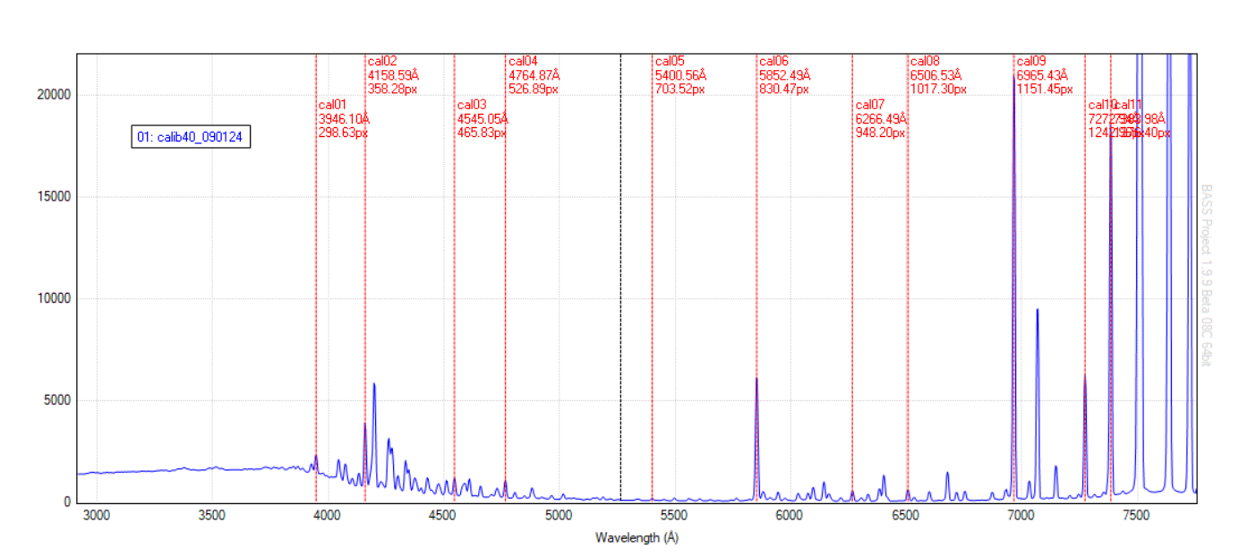

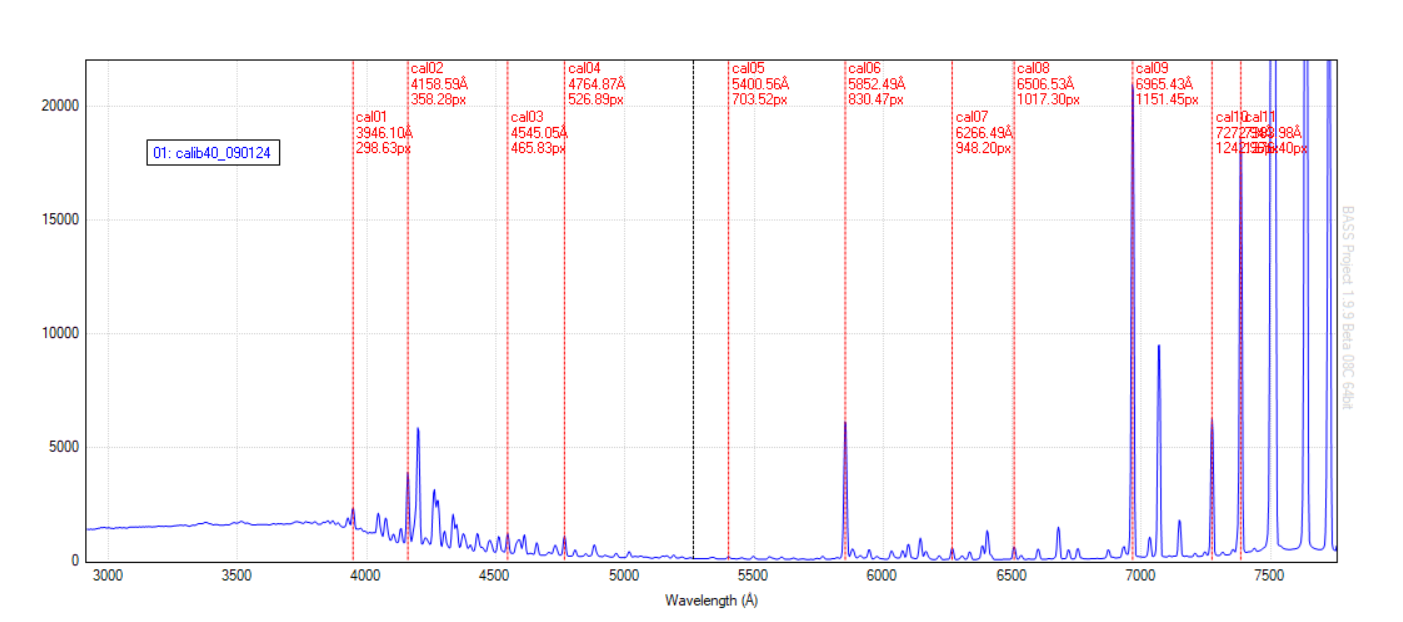

Hi Francois,
Thanks for the work to recover this site, it's great to be back. Here are my Relco calibration details:
Spectroscope: Alpy 600
Calibration lines:
7383.98
7272.94
7147.04
6965.43
6506.53
6266.49
5852.49
5400.56
4764.87
4545.05
4158.59
3946.10
Degree 4 polynomial
Hugh
