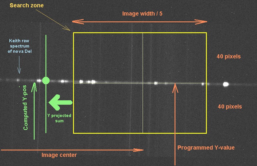

Attached, the screen copy shows how ISIS compute the Y central
position of the spectum (for each individual image).
The full algorithm is you autorize ISIS to compute vertical
position of the spectrum :
(1) determination of Y position for the individual images of a sequence (from
the given initial value - here give a good first guest value - see Calibration tab !)
(2) vertival registration of all the spectra
(3) addition of all the individual 2D imagse
(4) a new determination of Y pos from the sum image
(5) use this Ypos estimation for the final processing.
Keith I recommand a better orientation of horizontal
trace of the spectrum (tilt < 0.5°). Your actual value is 1.1°.
