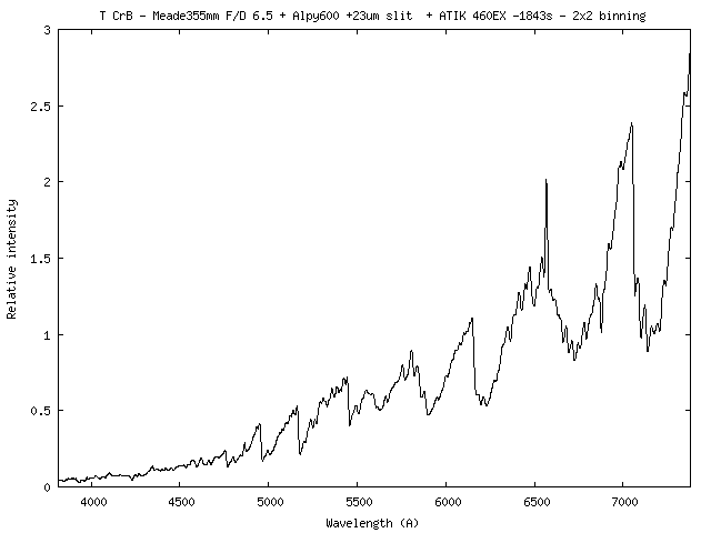

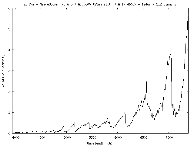

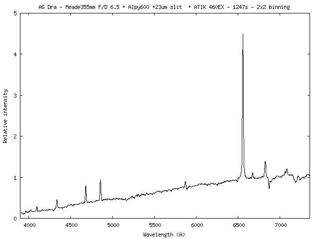

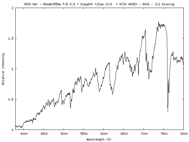

Some symbiotic stars of the last night :
Ag Dra
NQ Gem
T CrB
V934 Her
ZZ Cmi

Another spectra of AG Dra taken last night with a LISA and C14 : 20 exposures of 180s each.

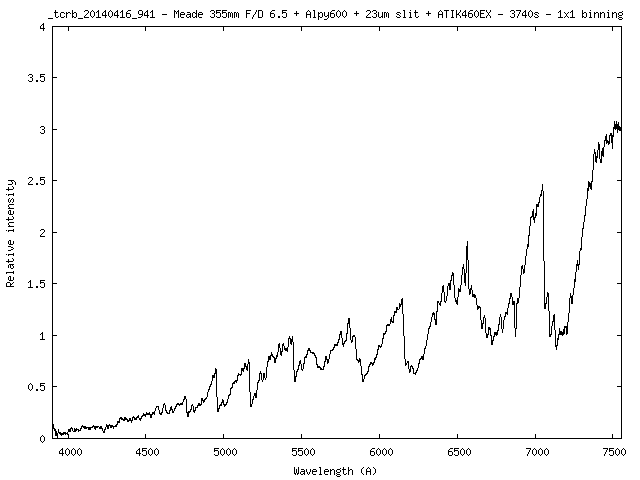

The last spectrum of the TCrB symbiotic with a 97% illumination Moon..
Alpy600 R 623

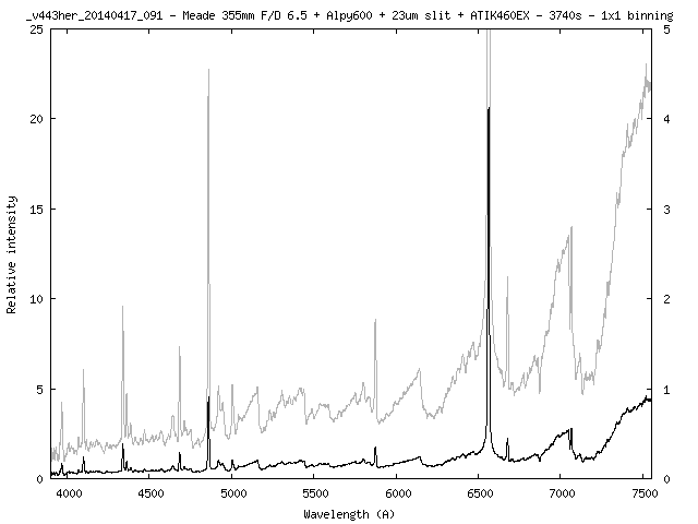

The symbiotics of the last night
T CrB
Ag Dra
V443 Her

La nuit dernière un spectre de T CrB (noter le double pic sur Halpha) :
