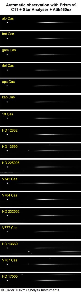

I have been playing with a Star Analyser last night. I set it up on my C11 (Losmandy Titan mount) with an Atik 460ex CCD camera.
This was the first time I was using Prism v9 with that mount. I decided to use Gemini ASCOM driver (v1.0.18.0 available from http://www.ascom-standards.org/Download ... rivers.htm) as well - a premier for me.
Prism v9 has a very nice feature which allow automatic observation. It is very easy to setup. I started with the bright stars in Cassiopae (in the integrated skymap, just lick on each target and add them on the observing list). I was impressed by the ability to do automatic acquisition in few clics... I recorded my session there:
https://www.flickr.com/photos/shelyak/1 ... /lightbox/

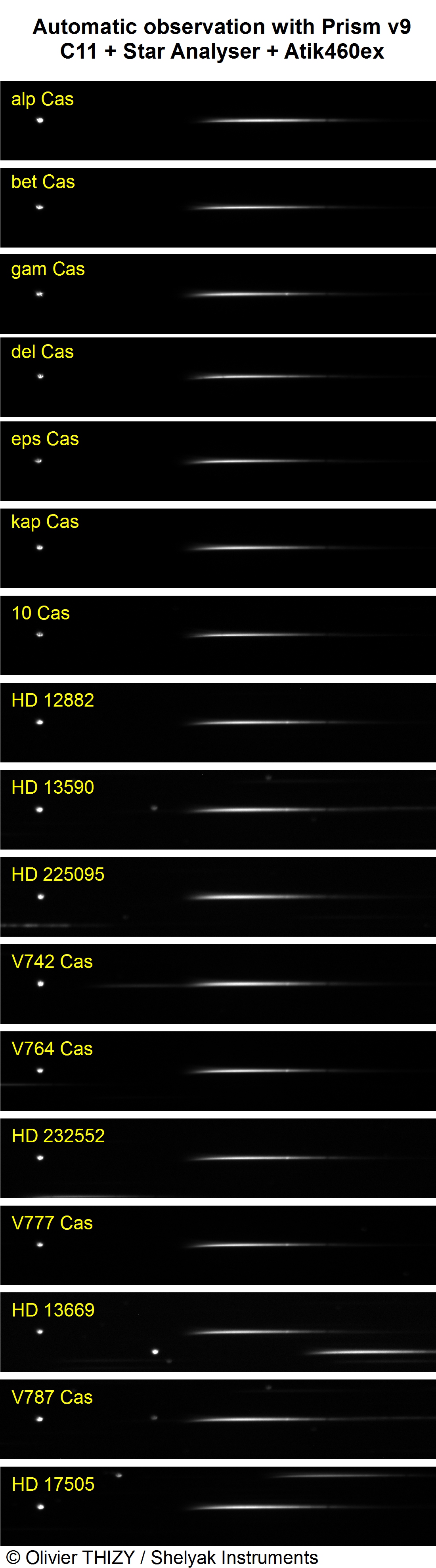

I then took an abstract of BeSS within the area (I just selected the RA within 0h-3h and DEC within 55-55°); another automatic run:
Result below... very easy to do, takes a little bit more time to analyse/process...!!!
