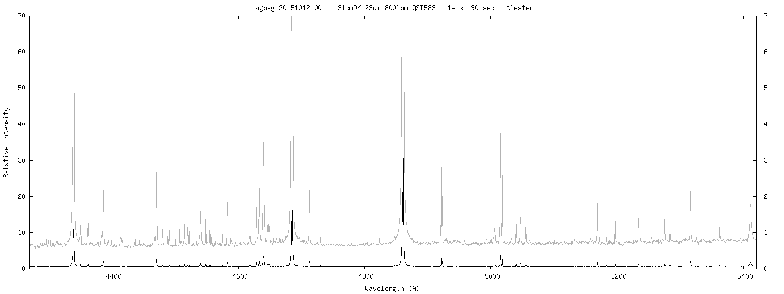

Re: AG Peg : Rebrightning Mag V = 7.5
Post by Tim Lester »
AG Peg for 2015-10-12. A further reduction of the Raman OVI.
