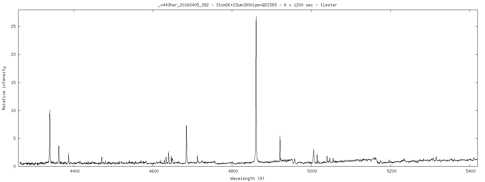

V443 Her at Hbeta
Post by Tim Lester »
Apr 5th result for V443 Her. Centered on Hbeta at R = 6000.
The OIII line at 5007 ang is 154 km/sec wide compared with the 4992 HeI line at 51 km/sec.
