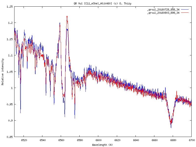

on july 28th I observed QR Vul and I observed it again tonight. Both confirm an outburst:
It is interesting to see that the emission has changed in a matter of few days - it may be worth to follow up on this star more closely from now on...

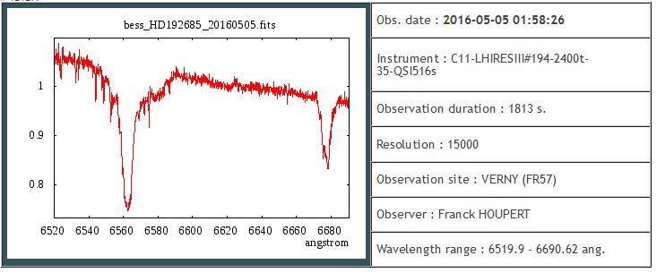

Here is last spectrum in ARASBeAm from Franck Houppert for comparison (taken 3 months ago):

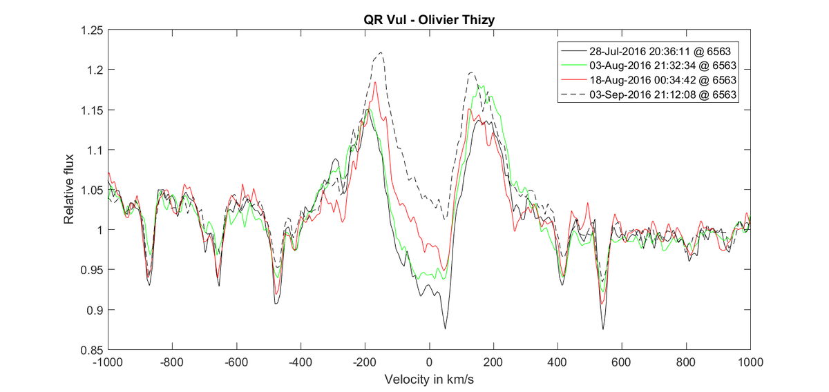

Emission is still well visible but note some changes over time:

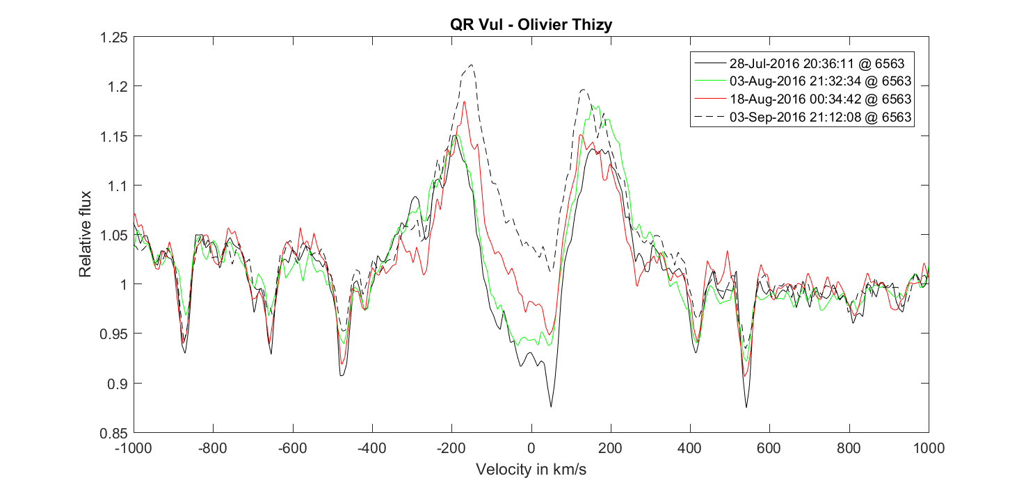

Another spectrum tonight...
The emission is getting stronger at the moment:
