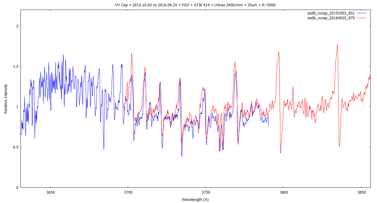

And an earlier attempt [3629 - 3790] with 2400/mm, with some defocus at both end and signal loss at left side:
But I was unable to identify these "reverse P-cygni" features above (couldn't find any line for them in VSpec - and Pickles is too low res), I'd appreciate explanation.

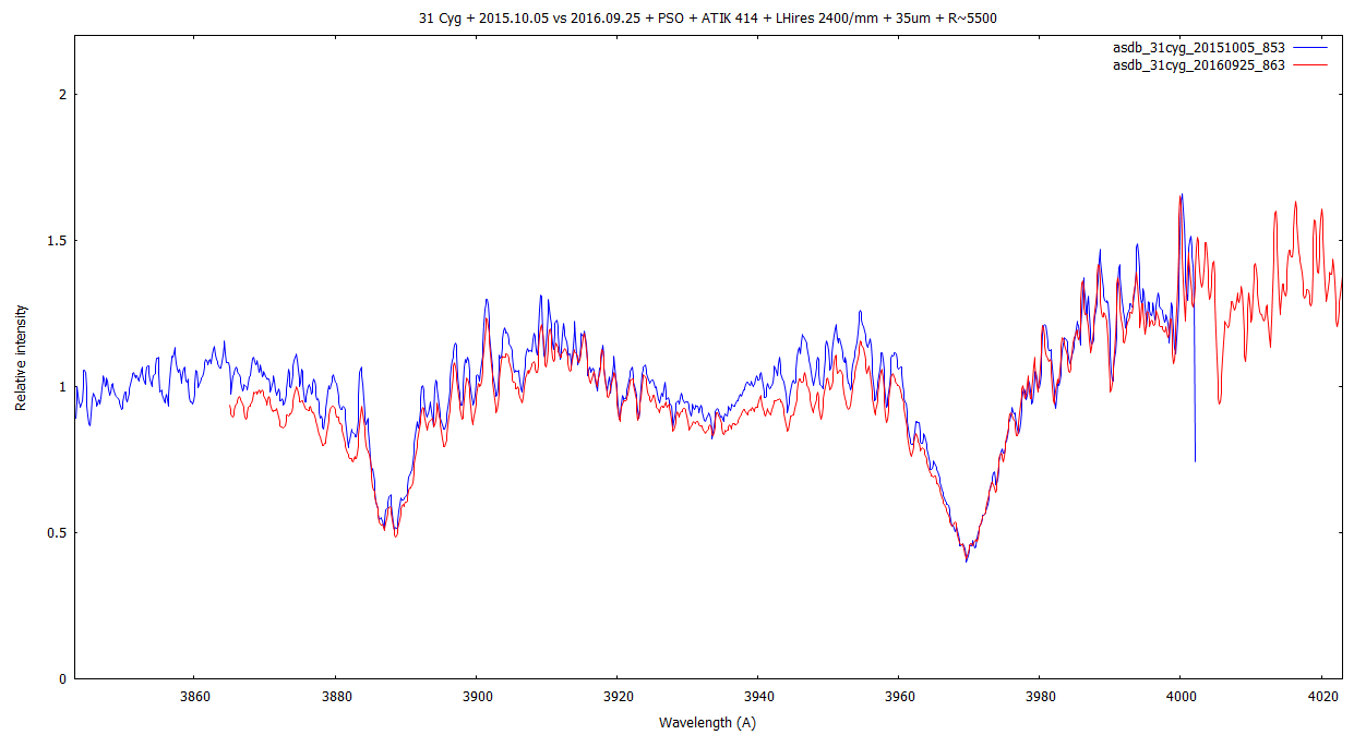

31 cyg:
Basically identical, continuum differs for some reason.

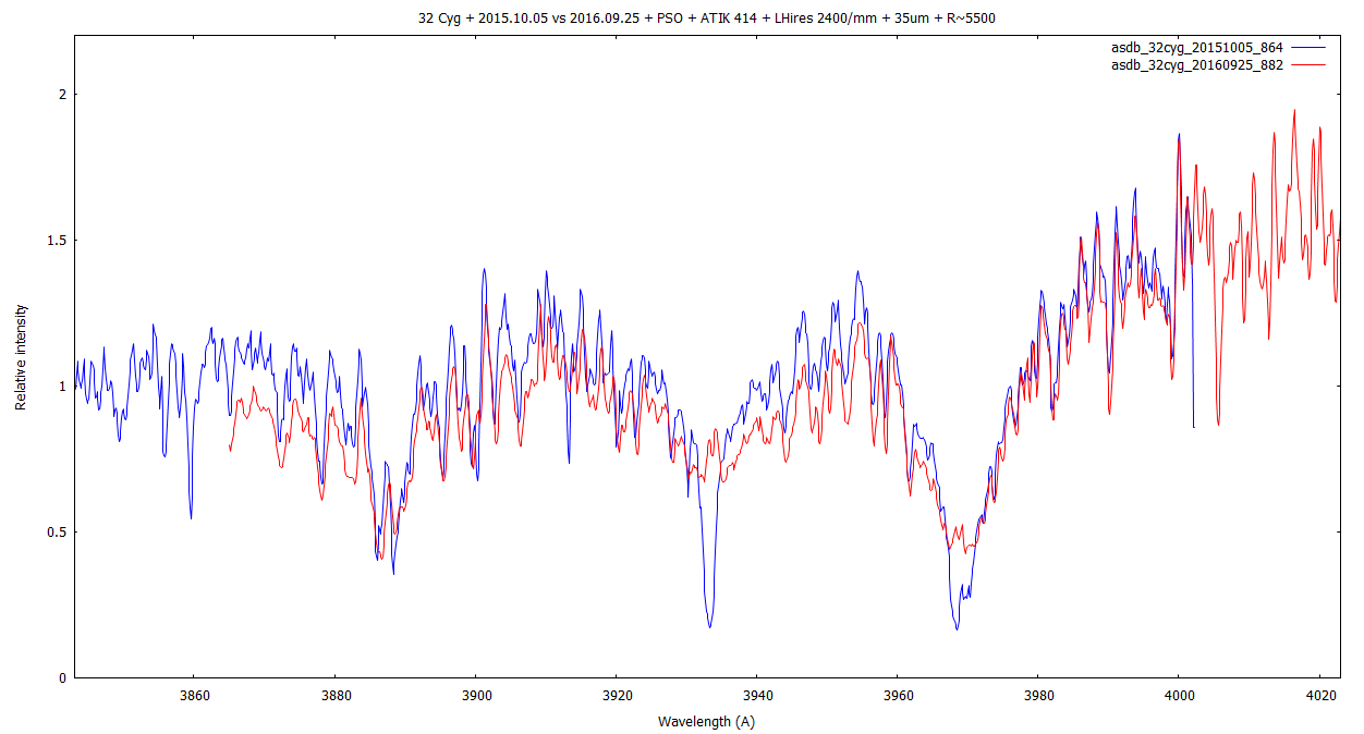

32 cyg:
First I thought taken the wrong star. However, did take a Deneb and Del Cyg just for fun, and they are both different. Comparing to 31 Cyg also shows different characteristics.
Is such a big change expected?
Be aware that above spectra (each 2 x 10 exposures) are mostly noiseless.
Made a deeper experimental UV region for VV Cep, had to fix the old 2015 wavelength + simply forgot to apply instrumental response for that one.
Now here is the compare:
Interesting that the reverse P-Cyg profile peaks did not increase seriously in this region.

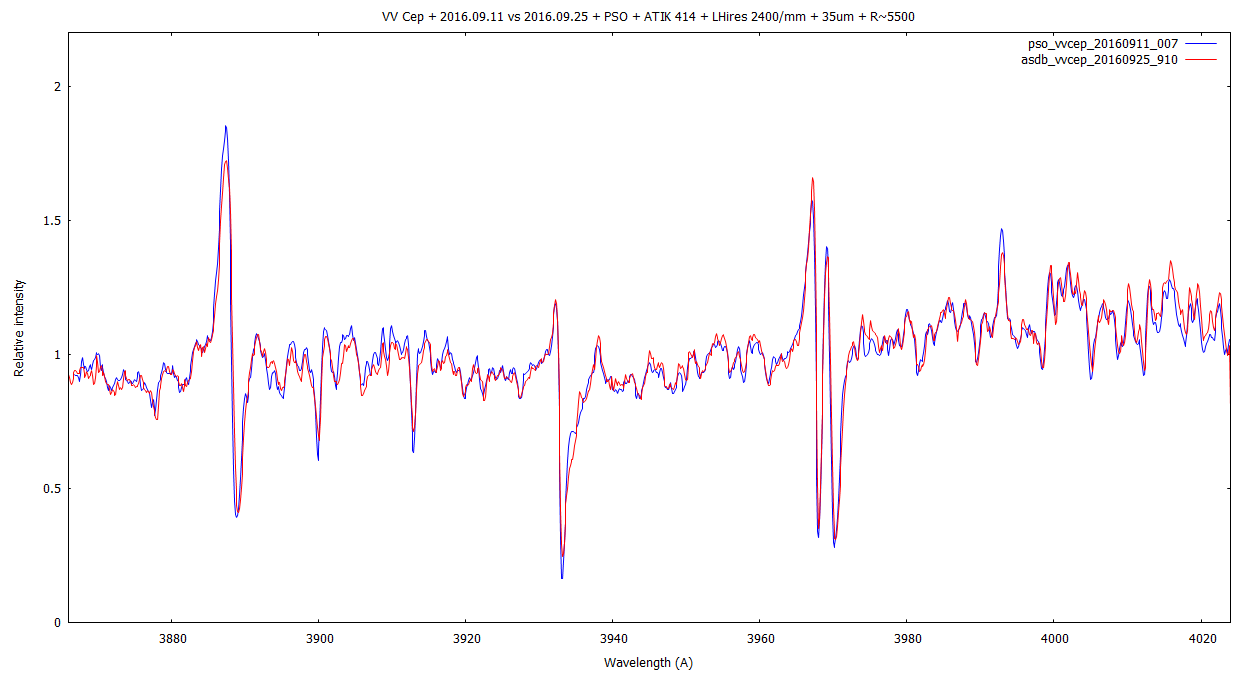

Finally, a change of VV Cep within this month:
Something changed at 3934A, what can it be?

Peter,
The inverse P Cygni lines in your UV spectrum of VV Cep are the higher Balmer lines (the deep absorption minimum is near line centre). Your spectrum shows, in order of decreasing wavelength:
H 2-11 3770.63 A
H 2-12 3750.15 A
H 2-13 3734.37 A
H 2-14 3721.94 A
H 2-15 3711.97 A
H 2-16 3703.85 A
H 2-17 3697.15 A
H 2-18 3691.55 A
H 2-19 3686.83 *missing* -- another absorption feature appears to be coincident
H 2-20 3682.81 A
H 2-21 3679.35 A probable
+ some possible higher Balmer lines.

Re: Zeta Aur Stars
Thank you Phil for the lines identification, there seem to be no surprise then.
