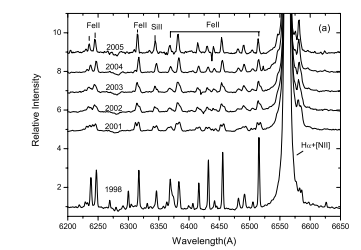

In http://iopscience.iop.org/article/10.1086/511181/pdf
Miroshnichenko et al. (2002) obtained triple peaked Fe II emission lines in their high-resolution observations. Forbidden lines such as [Fe II], [N II], [O I], and [O III] were observed in the spectrum of CI Cam. The presence of these forbidden lines indicates that the circumstellar (CS) disk material is geometrically extended so that there is a large amount of low density gas (Lamers et al. 1998) in the outer regions of CI Cam

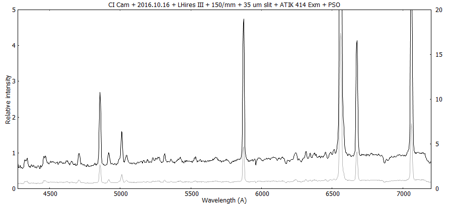

Yesterday unexpectedly I also got some clear sky, but with the 150/mm + 35um low res (ISIS: R~420). Now looking at plenty of spikes at Paolo's spectrum, I can see maybe the low res choice was suboptimal. Finally got 1 x 10 min + 1 x 8 min + 1 x 10 minute exposures with H-alpha little bit overexposed (2x2 binning seems now also a mistake). Decided a shoot short exposure later, but suddenly clouds appeared. Used ref. star HD 27322 at the beginning (clouds prevented to shoot again at end).
SNR should be good enough for the green part (3000 ADU bin 2x2), just the H-gamma blue end gets defocused as usual.

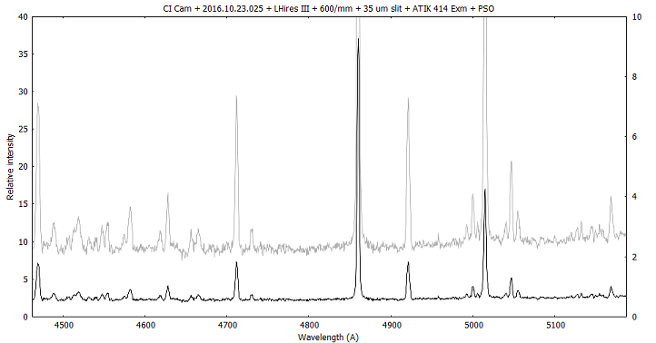

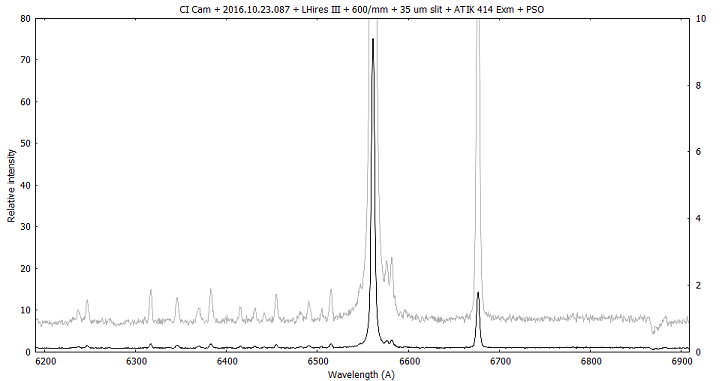

Last night's result, this time with the 600/mm grating (300/1200 Newton + LHires):
(6 x 10 minute, mostly clear sky, R~1800)
(3 x 10 minute, with cloud interrupts, R~2500)
(1 x 10 minute, clouds fully closed then, R~2000)

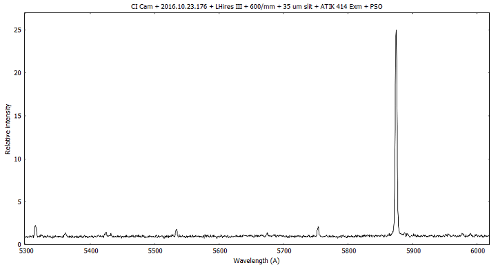

Although SNR is not the best for this last one, EWs look still usable.
If my understanding from alert notice is right, the mentioned [NII] 5755 should be the tiny peak left to the big He I 5876.
Line identifications would be appreciated.
