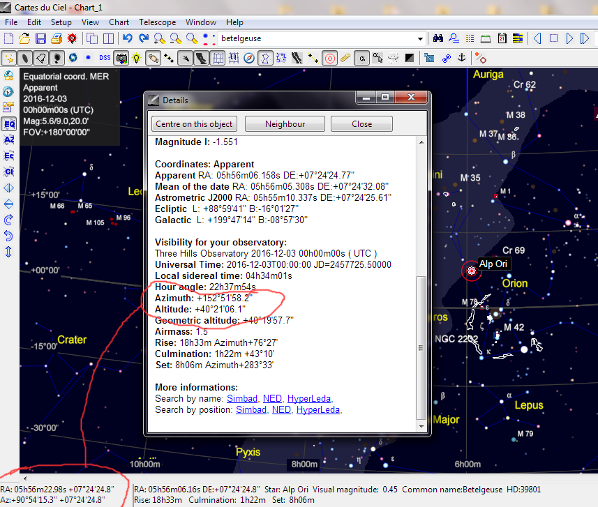

A bit off topic but I am guessing there are quite a few CdC users here. Has anyone noticed that the Alt Az coordinates for the cursor position (bottom left) are wrong if the map is zoomed out?
Alt Az bug in Cartes du Ciel ?
- CdC_AltAz_bug.png (208.22 KiB) Viewed 5206 times

Hi Robin,
I can reproduce your error. You get the correct Azimut and altitude in the corner at left bottom if you switch your coordinates from EQ to AZ (button on the left menu bar). Of course, the azimuth should not depend on this selection. You should report the bug to CdC. My version is V3.11.
Regards, Martin
Regards, Martin

Hi Martin
Patrick Chevalley has acknowledged the bug but reports it should be absent from the latest beta version. he says:-
Hi Robin,
I can reproduce the problem with the version 3.10 but not with the latest beta
3.11-3332
Can you install it from https://sourceforge.net/projects/skychart/files/0-beta/
Probably the early 3.11 version also exhibit this problem, but 3.11 change
almost every week and the first version with this number are more than two year
old. I know I take way too much time with this new version and I will make a new
release soon.
