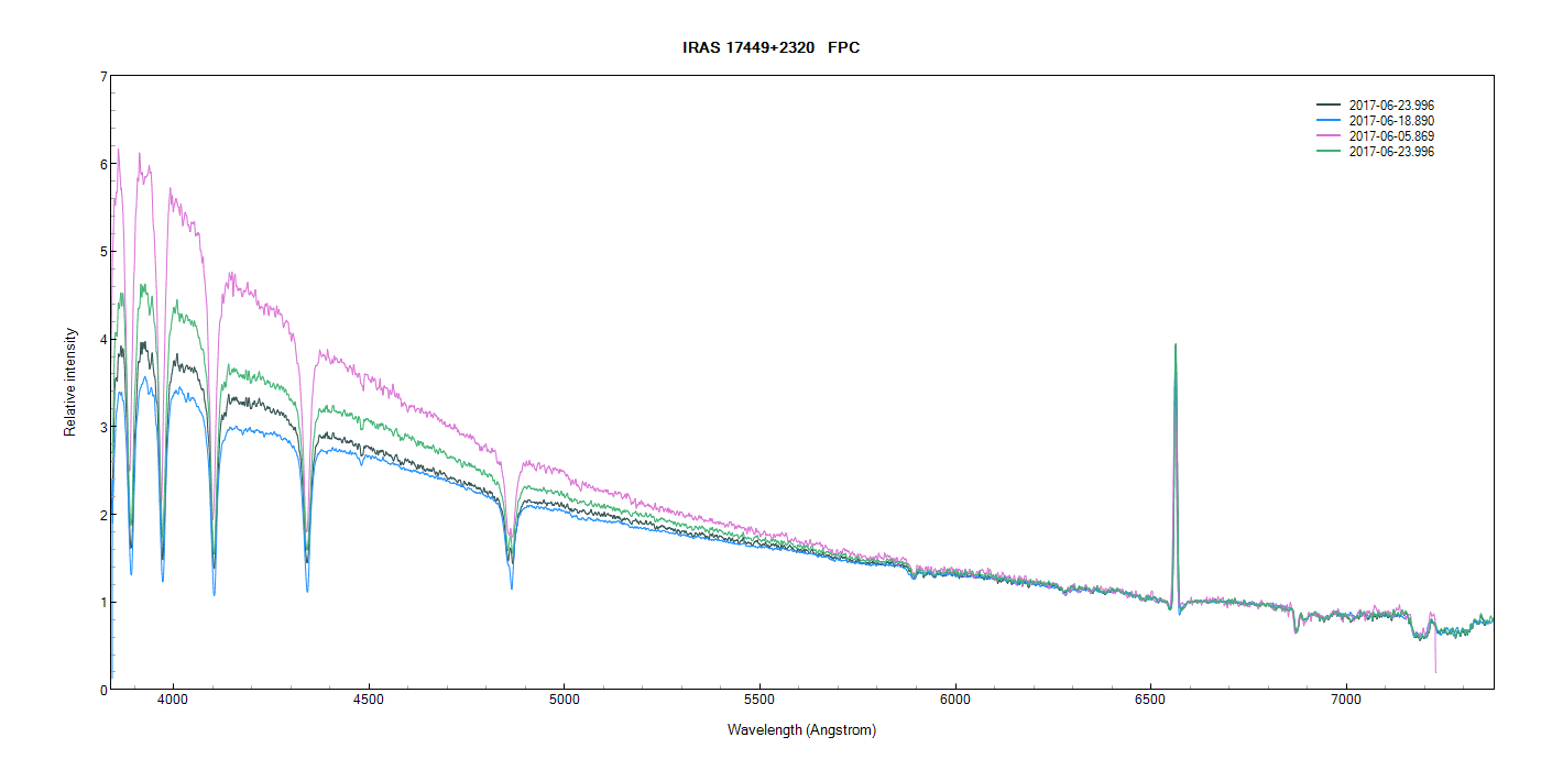

Here is a comparison between two nights. Even at low resolution it is clearly noticeable the changing profile of the H-beta band. But I'm worried about the striking difference between both profiles in the blue wavelengts, while in red wavelengs the match is almost perfect. The comparison star (HD 157728, A7 V) is the same, also the spectrograph and CCD. Te telescopes used are different: newton with Barlow lens the first one, and a RC the second.
Any idea? Are these differences real? Maybe a bit of B-band photometry could give a clue...

Re: B[e] star IRAS 17449+2320: call for observations
From Steve, about Photometry:
The problem is that except for Tycho there's almost nothing on this star, Francois. Korcakova has an amateur who's been getting occasional photometry but I have no idea how that's being reduced, what filters
(manufacture) are being used (other than being generically called V and R), or what the standards are. I'll check. In SIMBAD there are a stars that might serve, likely not variables (but internal checks take care of that), most are from Tycho and are on the faint side (most are fainter than V ~ 11) but a few are comparable brightness and would likely be in the same CCD field (at 10 min there aren't many and they're faint, at 20 arcmin the list expands considerably). From what we can see, the amplitude is quite small, no more than a few tens of millimags, but we don't really know what to expect. Having BVR would be much more useful since the R filter contains Halpha and that's very strong relative to the continuum (variability could be accounted for by that line alone, for instance, if you push the interpretation).
Fran: looks to be a severe issue with instrumental/atmospheric correction

Francois Teyssier wrote:From Steve, about Photometry:
Hi, François
I'm quite worried about this issue. The last night, by a suggest of Joan Guarro, I took another spectrum but with two comparison stars: HD 157728 (A7 V, the star I use regularly, green spectrum) and pi Ser (HD 143894, A3 V, dark spectrum). The spectra obtained are a bit different, as yo can see here.
All spectra are, of couse, flat-field corrected, average of 20 flats exposed at 2/3 of the full histogram. But of course, at short wavelengths the response is lower.
I have been comparing spectra of T CrB processed with Pi Ser and they match almost perfectly in all wavelengths, so I don't really understant what's happening.
By the way, interesting the behavior of the H-beta band, changing every few nights.
iras17449+2320_ 20170623_996_FPC Hbeta.png (25.41 KiB) Viewed 10309 times
Greetings
Fran
Hello Fran,
This is atmopheric correction
Such variations of the continuum are not expected for that star
More, important variations would produce large variation of the luminosity; this not the case.
Nice variations of the lines!
