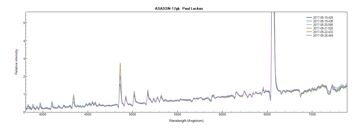

Aside from oscillating hydrogen emission lines, there's still little change noted in ASASSN-17gk (Nova Cen).
Paul

Re: Bright nova in Centaurus
Hi Paul,
Great serial spectra...
