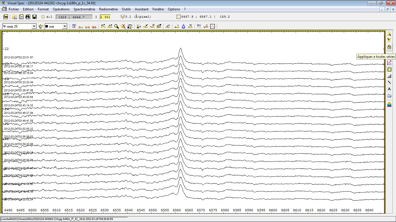

A sample of one hour observation of CH Cyg for the night March 24, 2012:
The spectra are taken with a Celestron 11 telescope (0.28 m diameter) and
a LHIRES III spectrograph equiped with a 600 grooves/mm grating and a 23 microns
slit (for a spectral resolution power of R = 3500).
The time resolution is of 180 seconds (a spectra obsrerved each 3 minutes). The
SNR is decent with these configuration.
We can observe signifcant profile evolution (to be confirmed
The important questions: more observation are requested ? Satellite observations are finished ?

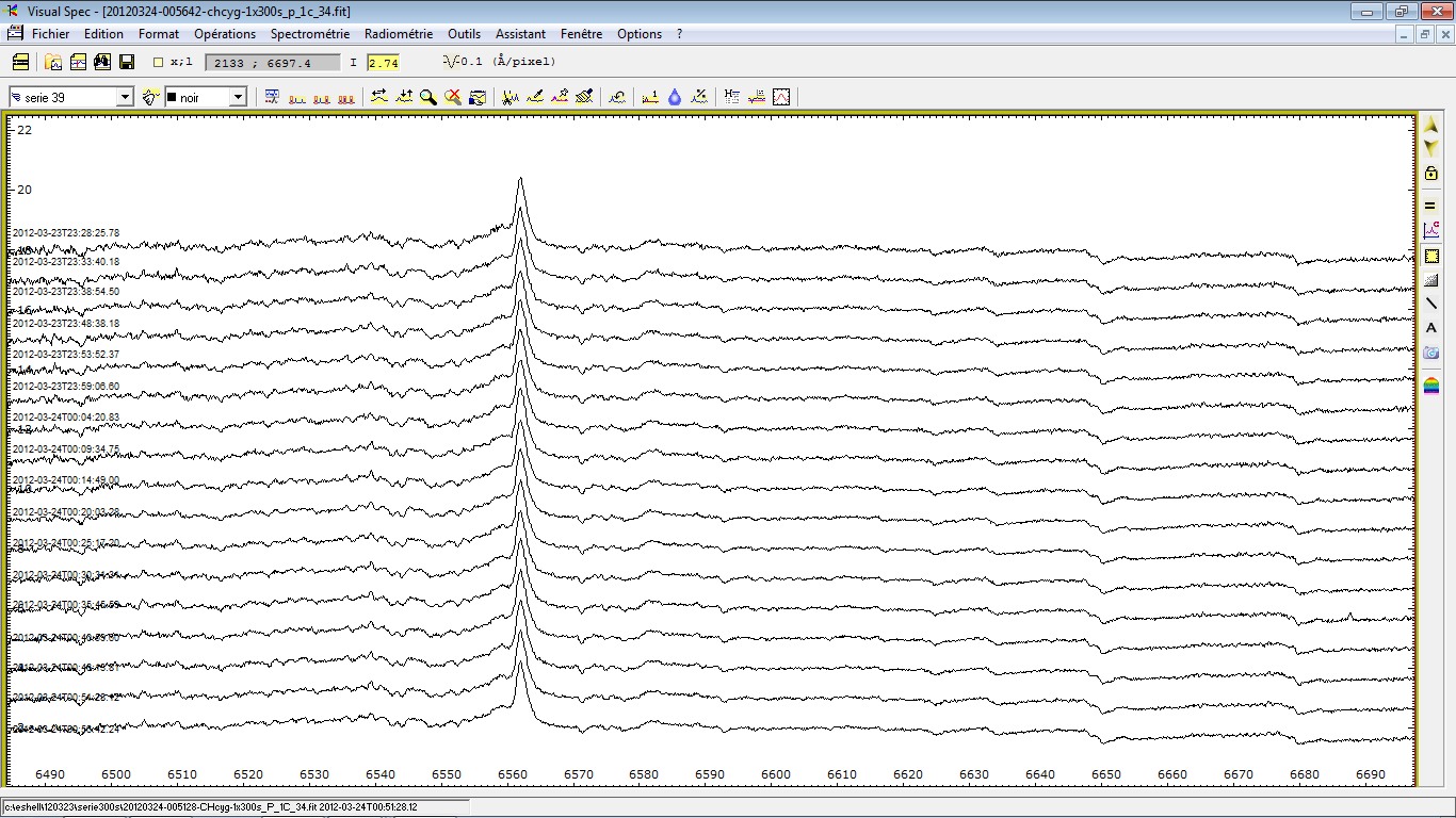

Yesterday observations, 1 Go of data, 6H of time series of 180s and 300s individual exposures doesn't show obvious periodic variation of the H alpha line. Only during several hours a growing blue H alpha peak. I haven't finished to reduce all the spectra at different time resolution, 1h, 180s and 300s.
Christian, there is a lot of possibility of blending on this star and your variations seems to be blend. But perhaps with a slighty more resolving grate, 1200/1800, it could be more easy to probe the seeking 500s period. Well perhaps doesn't exist at all.
Stephane Charbonnel with its 500mm as done a wonderful observation of only 100s individual exposure (24.045, 24.096 March). It is under its range no variations seen in his spectra.
Some plots:
Some plots:
Re: AAVSO Alert Notice 454: Monitoring of CH Cyg requested
Hello Christian,Christian Buil wrote:A sample of one hour observation of CH Cyg for the night March 24, 2012:
We can observe signifcant et true spectral profile evolution!
The large drift in wavelength of the H alpha peak is interesting (~1A) I have not seen shifts anywhere near as big as this. Is the calibration stability confirmed?
- Posts: 1424
Hello Robin,
Relaod the page. The graph is updated with all my data available and better spectral calibration (time variation fllexure on Lhires is a permament problem).
eShel data seem not show Halpha peak intensity variations... more observations needed.

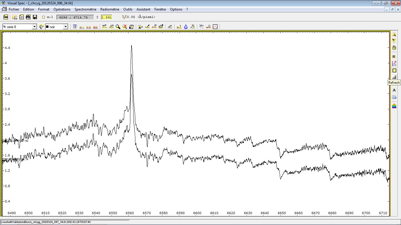

I send you two graphes.
Instrument : T500F6 Eshel#112 ST10XME
Site : Durtal(UAI949)
Last night : 24/03-> 25/03.
First is an extract of 30 min with a serie of spectra around Halpha (order 34). Exposures are 200 seconds (Star is very low at this time). I can notice no variation :
Second is an extract of 30 min with serie of spectra around Halpha but exposures are 150 seconds.
I can notice yet no real variation but it is not easy to see small variations in such graphes. Christian, I send you all fits file of ordre 34.
Stephane
Stephane
