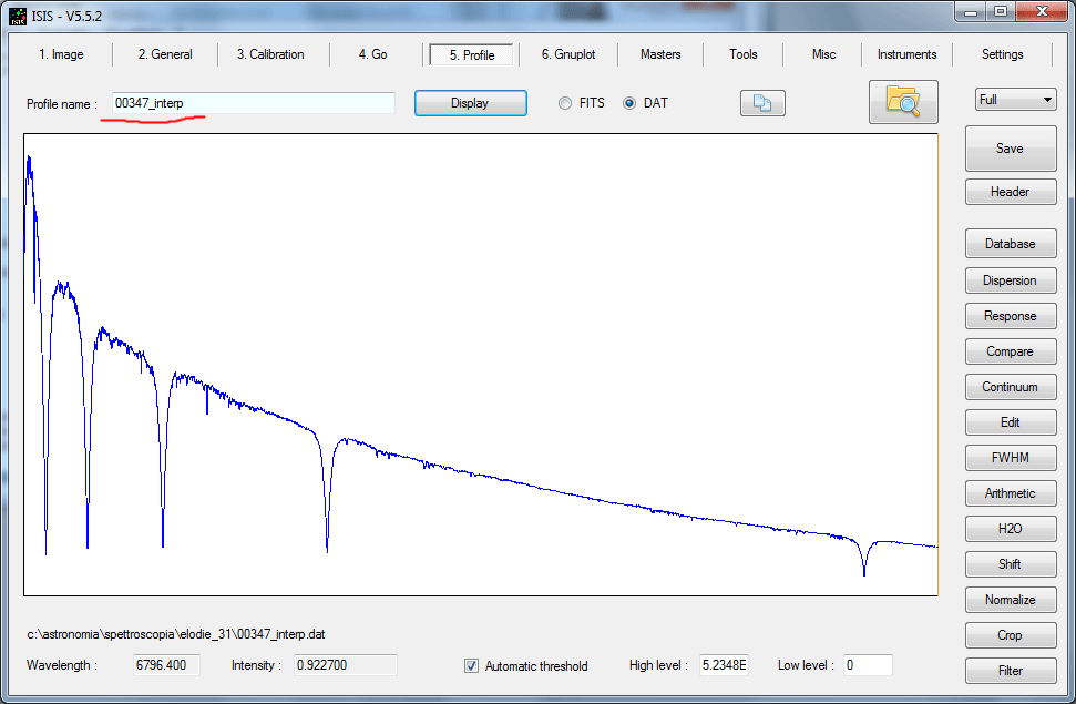

Okay Robin, the spreadsheet now doesn't plot zero values (workaround):
Small range plot:
Pressing the button Interp "Show" you can see how the interpolated profile (red) fills the missing data (as I said, it is a simple linear interpolation between the adjacent non-zero data).
For our purposes (response curve calculation) we could use the interpolated profiles always created by the spreadsheet with the Export button. You'd just have to copy the xxxxx_interp.dat file(s) from EXPORT folder to the working directory.

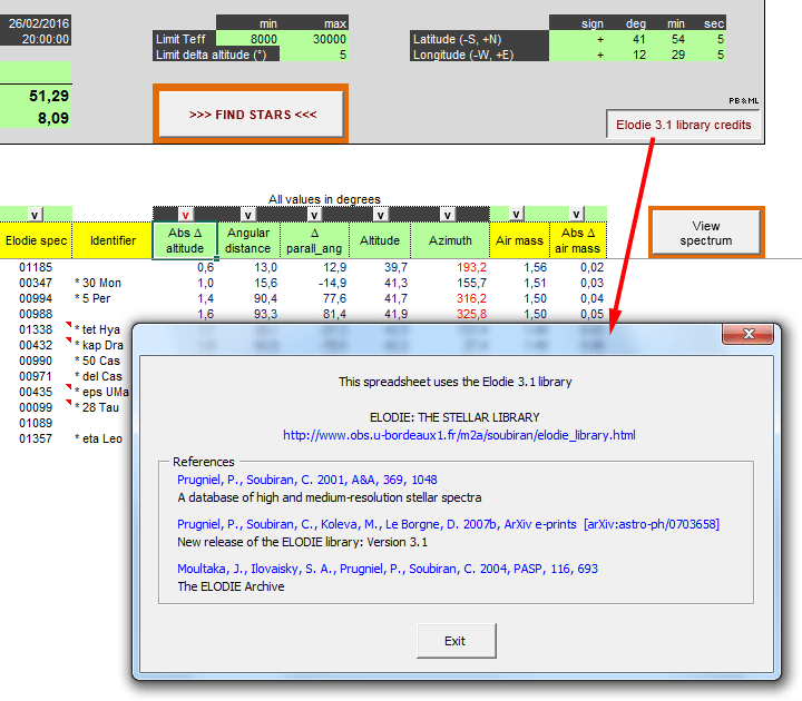

This screenshot shows the frame for credits. Hyperlinks allow to retrieve related papers:
