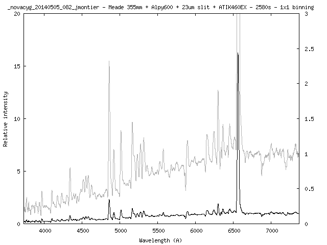

The spectrum of the last night with Alpy 600

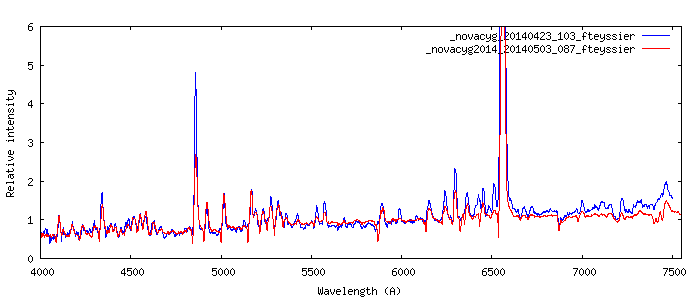

From April 24. Emission lines dropping and p Cygni profiles returning.

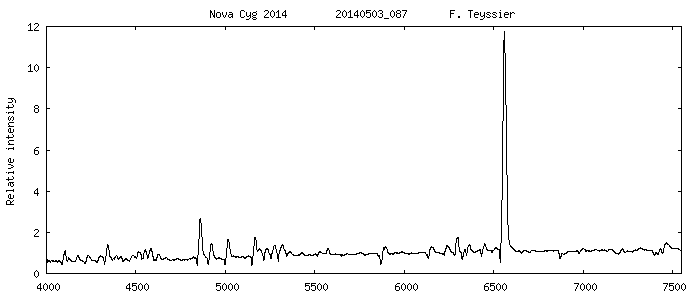

Nova Cyg 2014 the 03-05-2014
Absorptions detected by Tim the 24-05 remains
Comparison with spectrum obtained on 23-05-2014

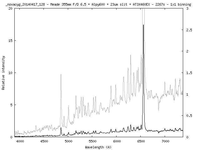

Some unpublished ancient spectra of Nova Cyg 2014. Halpha at very high spectral resolution (R=47000 - Vhires),
but only 2 x 600 sec exposure (April 16):

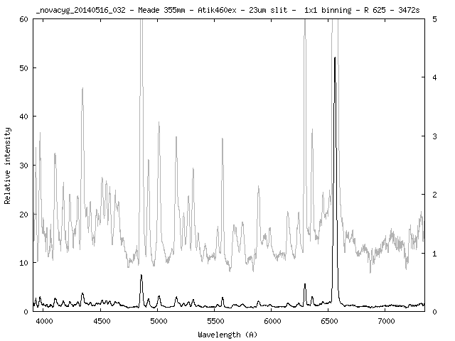

Nova Cyg Spectrum of the last night (R 650)
