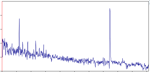

Hot off the press from last night!
ISIS is reporting a resolution of 1920.

The same at the same moment with LISA (slit 23 mcm and binning 2x2)
The resolution of Tim's spectrum is noticelly higher.

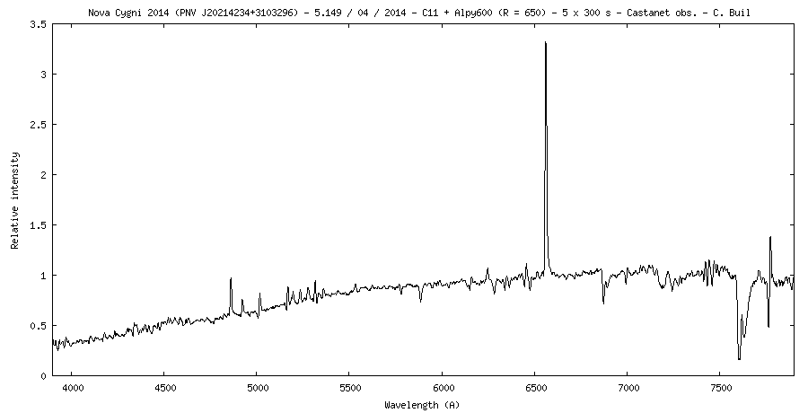

Also a Alpy 600 spectrum taken the April 14.1 with a Celestron 11 (7 x 300 sec):
Short time change (compare with April 9-10 spectra).

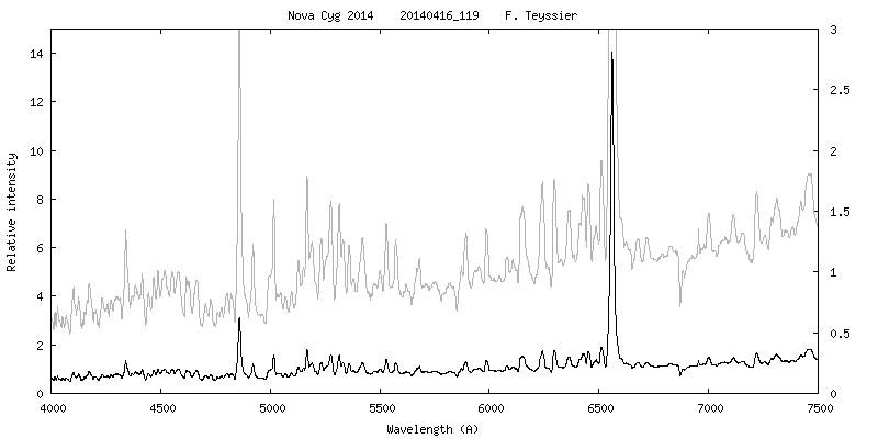

Spectre de ce matin
La courbe de lumière est particulière avec semble t-il des oscillations.
Spectre de ce matin

New spectrum this night
A spectrum by night should be welcome in the data base.
The evolution weak feature at 6828 could be very interesting.
