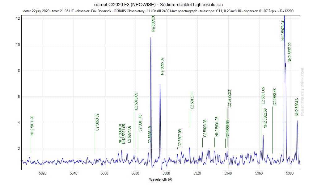

On 22 July I was able to take a spectrum of the comet c/2020 F3 (NEOWISE) in a narrow observation window (understandable in time) with the LHiRESIII and 2400 l/mm. The comet was followed on the core and the slit was positioned on the photocentric core. slit 32µm and C11 telescope on f/10. The aim was to observe the Na-doublet. An instrument response was performed on a nearby suitable star. Exposure time was 4 x 600 sec. I could not detect a doppler shift.
best regards
Erik.

Re: C2020 F3 (NEOWISE) spectrum
Erik Bryssinck wrote: I could not detect a doppler shift.
Nice result Erik. That extends the time of Na D emission beyond my 2020-07-20 result
The comet was just about at its closest to earth so low RV (JPL Horizons gives just -0.7km/s RV geocentric)
Date__(UT)__HR:MN R.A._____(ICRF)_____DEC T-mag N-mag delta deldot S-O-T /r S-T-O
$$SOE
2020-Jul-22 21:30 10 24 58.63 +44 52 58.5 6.298 16.106 0.69189059531969 -0.7699724 37.3162 /T 100.6790
2020-Jul-22 21:35 10 25 02.78 +44 52 41.2 6.299 16.106 0.69188906883369 -0.7523755 37.3227 /T 100.6712
2020-Jul-22 21:40 10 25 06.92 +44 52 23.9 6.300 16.106 0.69188757763562 -0.7347802 37.3292 /T 100.6635
$$EOE
Robin Leadbeater wrote: The comet was just about at its closest to earth so low RV (JPL Horizons gives just -0.7km/s RV geocentric)
Can you see the NaD absorption lines in the scattered sunlight? These should have been shifted redward by a total of 38km/s according to JPL Horizons
