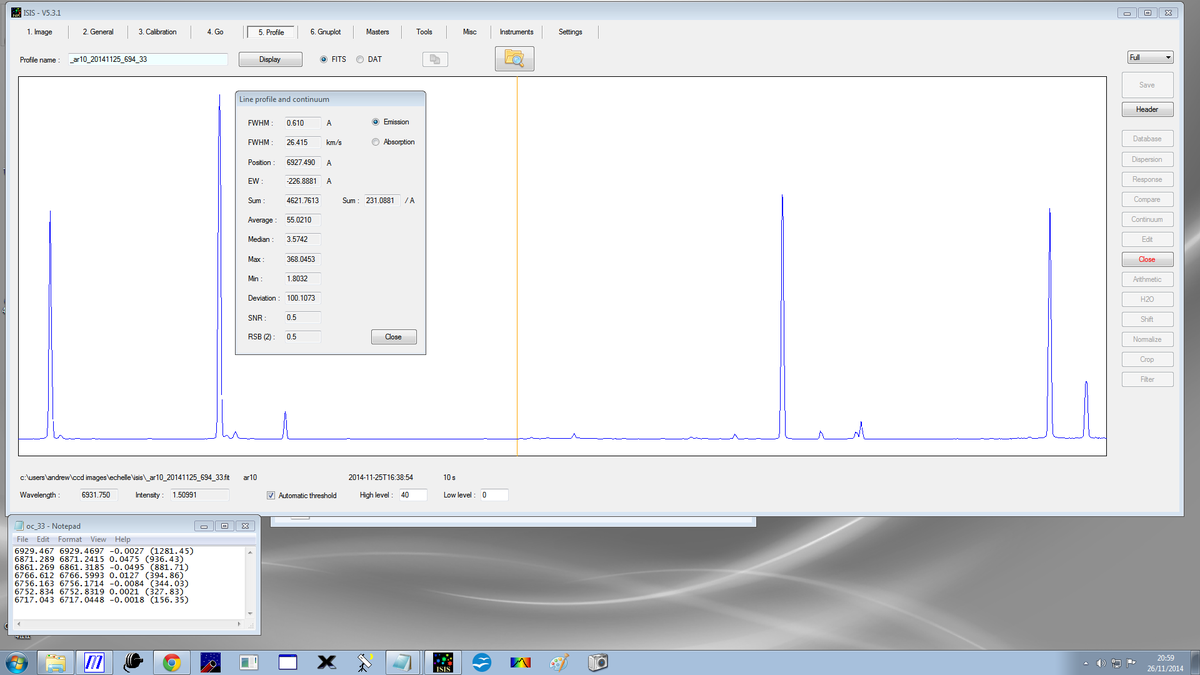

hi, I have been trying to validate my use if ISIS for processing my echelle spectra. I attach a screen shot which shows order 33. The problem I have is that the calibration solution is very good but measuring the peak at 6929.467A show an error of about - 2A error compared to the oc_33 listing of -0.0027.
Am I doing something wrong?
The calibration is from a Relco lamp rather than ThAr.
Thanks for any advice.
Regards Andrew

I think I have solved my problem. I have adjusted the gamma setting to make the "Camera Test" circles match the spacing of the lines I picked on order 34. Now the RMS fit values are even better and the error in the line in profile 33 gone. The only underlying concern that the value is lower than that which I measured.

As a physicist I have followed the rule - "if all else fails read the instructions" and have now adjusted the alpha angle as advised to do in the eShel instructions. Sorry for being such an idiot!
