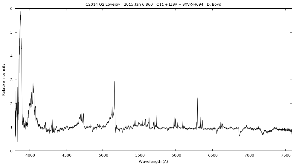

Spectrum of C2014 Q2 Lovejoy taken on 6th January at an altitude of 33 degrees on the meridian. Total integration time 110 min.
Best regards, David
