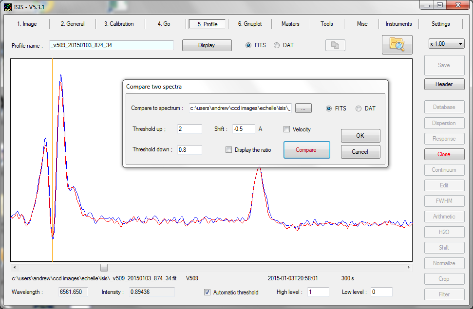

I thought I would use my echelle to look at rho Cas and V509 Cas. I managed to record some spectra on 3rd Jan but as the temperature was falling quickly it exposed the limitations of the wooden prototype as I got a 0.5 A shift in 40 minutes (see attached images comparing the first and last iof 8 by 300s spectra of V509). So my intention is to use a ceramic floor tile as the main base and insulate the whole to maintain the temperature at least over an hour or so. If this fails I will try some active temperature control.

V509 temperature shift over 40 mins

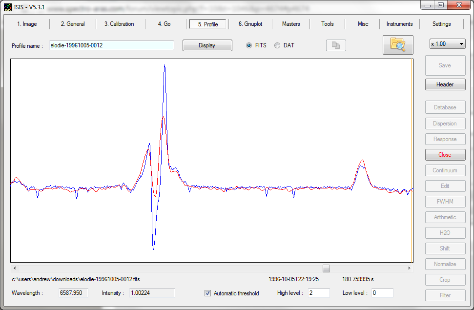

I have now found a spectra of V509 Cas on the ELODIE archive which compares favorably with mine. I attach the comparison with 1A shift. Mine is red, Elodie blue.
Thanks Andrew
Elodie v my Echelle V508
