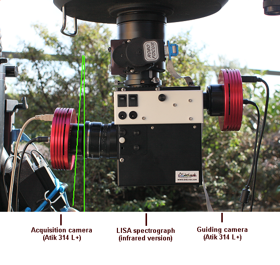

Hi Christian,
Is it an optical illusion or is the imaging camera at an angle?
Posts: 370
Re: Jupiter spectroscopy: polar arc observation
Post by Olivier Thizy »
Robin,
LISA exists in two versions. In near Infra Red mode, the acquisition CCD camera is tilted for niminal resolution.
Olivier
