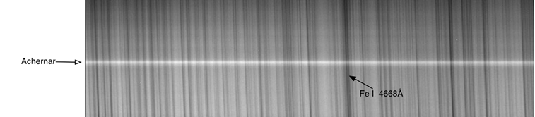

Very nice. Here's another cosmic perspective - this time of the star Achernar - taken during the day last November while setting up a new Lhires III, centred around 4655Å:
Paul
Re: Cosmic perspective during twilight time
Thanks for sharing Christian, very instructive poster and wonderful ambience during dawn time! Several telluric lines frequently interfere with our spectra (but also help to check the wavelength calibration!).
Paul, a star spectrum during daylight? Fantastic!
