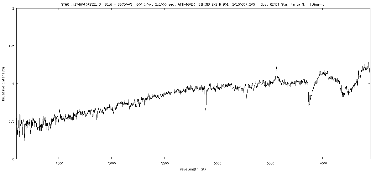

Re: symbiotic nova J17460t0-2321.3 Campaign
Hi all:
The graph is very schematic, only the result of two integrations of 1000 seconds.
The star of comparison, HD158643, shows activity in the Halpha.
J.Guarro
J.Guarro
- _j17460t0+2321,3_20150307_205_J. Guarro.png (9 KiB) Viewed 5042 times
Yes HD158643 (51 Oph) is classified by Gray and Corbally as an Ae star (A0 II-III(e) table 1 here)Joan Guarro Flo wrote: The star of comparison, HD158643, shows activity in the Halpha.
http://cdsbib.u-strasbg.fr/cgi-bin/cdsb ... .116.2530G
It might be worth checking it against a MILES star or similar to be sure the continuum is typical of an A0v
