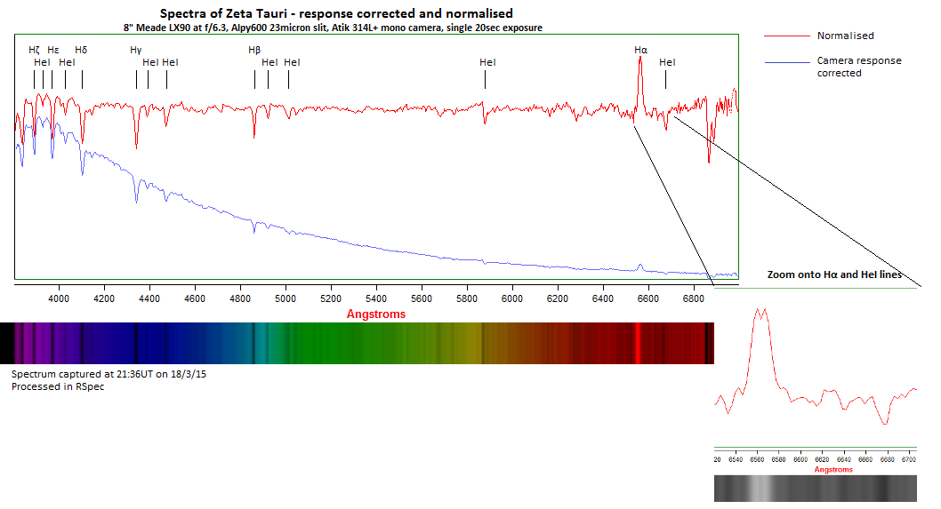

A few weeks ago I captured my first spectrum of a Be star (see attached presentation). I was pleasantly surprised to see that I had resolved the doppler split in the Hα emission line. On my spectrum the two peaks are separated by 7Å which I think would equate to a velocity difference of about 300km/sec between the two sides of the rotating shell of gas. Should I have expected to resolve this split with my set-up? (8" Meade LX90 in Alt-Az mode, f/6.3 focal reducer, Alpy600 guiding module (23micron slit), Atik314L+ mono camera. Or maybe I could have expected a clearer resolution of the two peaks?

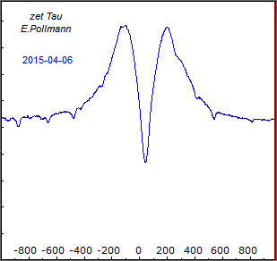

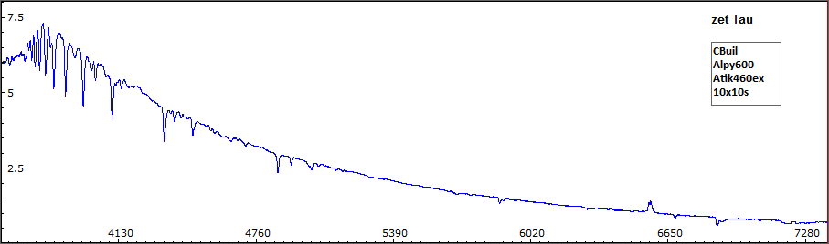

I'm not an alpy user but welcome to the Be Star observations. You are right on the double peak width as it shows below on a hires spectra from BeSS. I'm posting as well the alpy spectrum from C.Buil taken recently. Congratulations. Do not hesitate to look at the BeSS data to compare.
