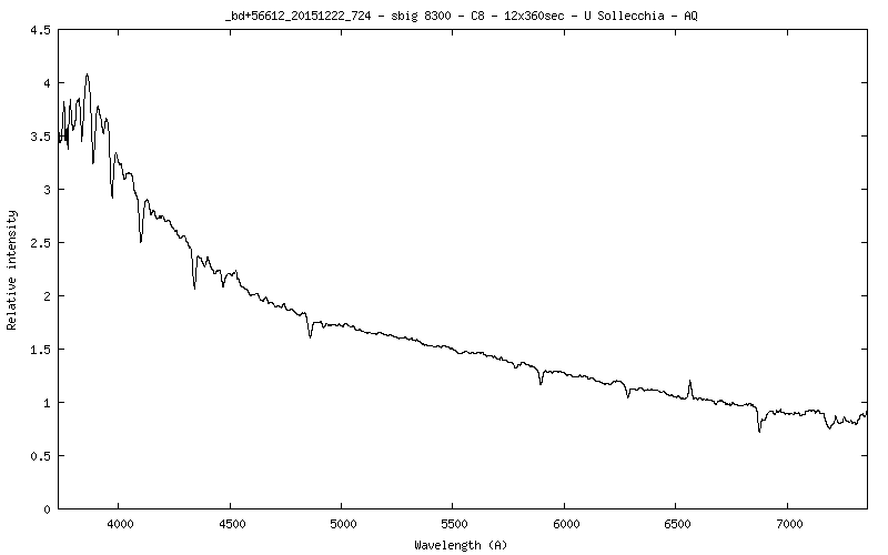

BD+56 612 H-alpha émission
Posts: 247
Post by umberto sollecchia »
Bonjour,je informe que le H-alpha de cette étoile, de l'absorption est devenue émission.
Quelqu'un peut confirmer?
Profilo bd+56612.png (4.97 KiB) Viewed 4462 times
Cordialemente Umberto
Re: BD+56 612 H-alpha émission
Sorry for the late reply Umberto! Interesting what you've found. I was able to observe the star with Lhires III 1200, finding the h-alpha line clearly in emission status (double-peaked).
