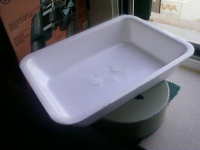

I used a packaging for chicken wings from the supermarket, made of some interesting type of Styrofoam, or poly-something-tane plastic, that is very easy to cut, light, and resistant to humidity. Very handy!.. It also looks very promising for making rear-illuminated diffusers for flatfield screens. This plastic was then wrapped in black tape to make it dark and lightproof..

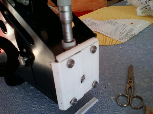

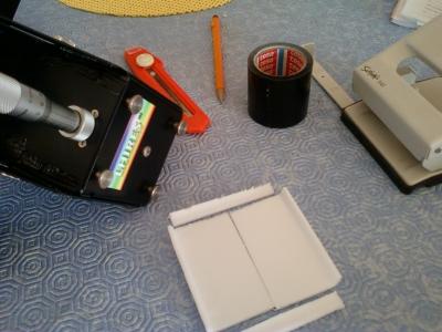

I've cut the packaging in a way that would make a cover over all hopes on the back of the spectrograph, and punctured holes in the places the screws hold the grating holder. You can see the idea in the images!
I can now take spectra of calibration lamps in daylight that looks indistinguishable from night time :) No more lightleaks!

The original Chicken packaging
Cut into pieces; and tools needed
Placed on the back of the spectrograph
