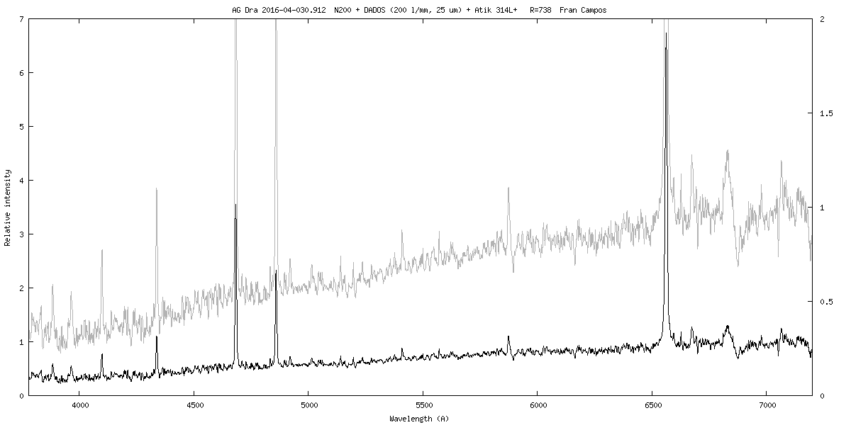

AG Dra 20160430_912.png (14.37 KiB) Viewed 7576 times

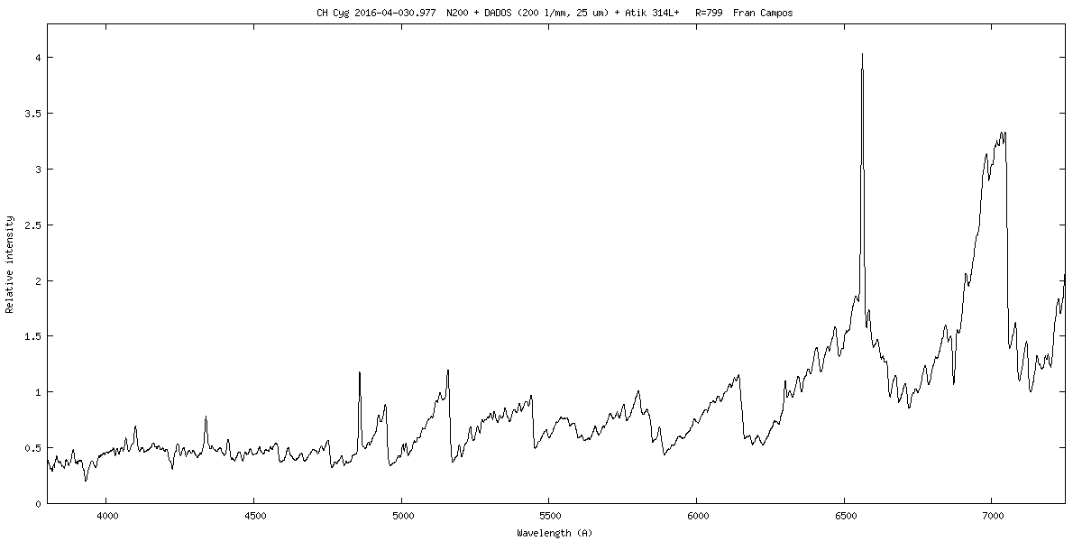

CH Cyg 20160430_977.png (9.1 KiB) Viewed 7576 times

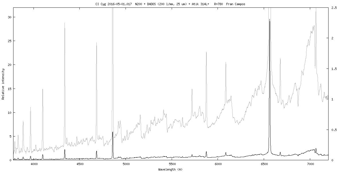

CI Cyg 20160501_017.png (12.13 KiB) Viewed 7576 times

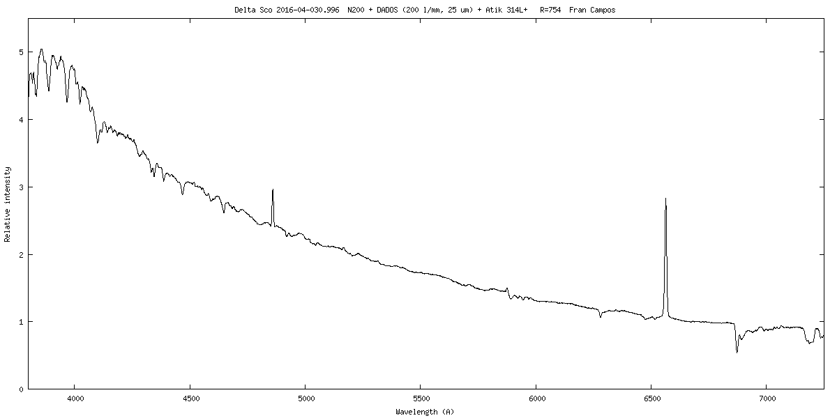

Delta Sco 20160430_996.png (6.65 KiB) Viewed 7576 times

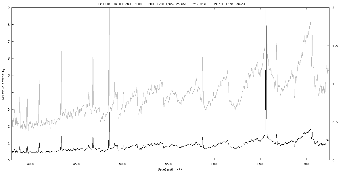

T CrB 20160430_941.png (13.59 KiB) Viewed 7576 times
