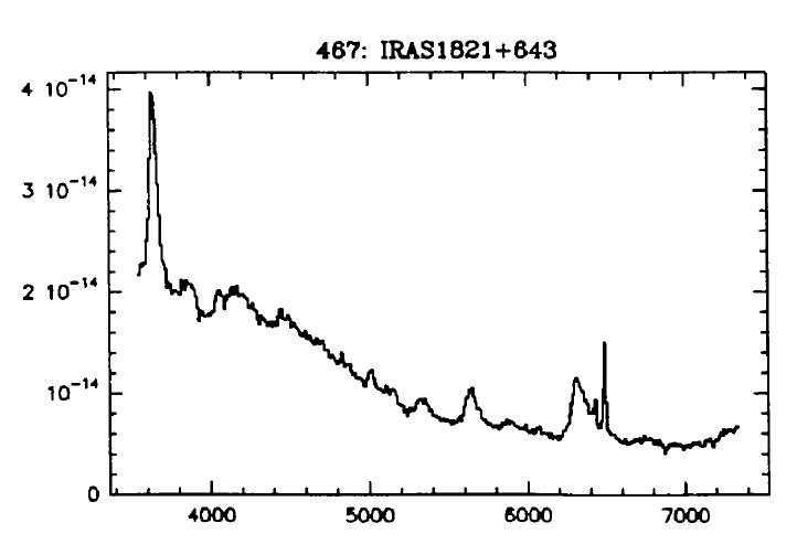

Tracking the reference given in Simbad for the redshift it seems to come originally from this paper.
http://ukads.nottingham.ac.uk/abs/1992A%26AS...96..389D
IRAS 1821+643 in table 2 and the spectrum shown in fig 2

Hi Etienne,
The Balmer lines from the Seyfert galaxy core are the broad lines at ~5650 (H gamma), 6300 (H beta), not the narrow (nebular? ) line at 6495 (redshifted O[III] perhaps?)
Re: KUV 18217+6419 et VV_Cep
Bonjour Robin,
Tu as tout à fait raison j'ai interverti la raie [OIII] et Hbeta !! :oops: peut être le manque de sommeil...
Avec [OIII] à 5007A je trouve 0.2972
