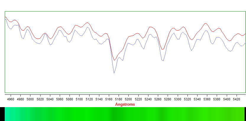

Hi Etienne,
I just noticed your post. I have previously used the solar magnesium Fraunhofer lines to tune my Alpy. These are the magnesium b lines, in particular I look at the gap between the b1 line at 5183.6Å and the other merged b lines at 5173.7Å - 5167.3Å. The gap is close to the ~10Å resolution of the Alpy so I change the focus until I find the maximum resolution of the gap. I attach the improvement I made when I last re-tuned my Alpy, the red curve is where I started and the blue curve is where I ended up. I'd be very interested to see your own spectrum of sunlight to see how well you are resolving this gap
Hugh
Hugh
- Sun Alpy tuning.png (10.44 KiB) Viewed 7176 times

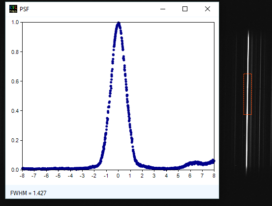

With LISA, I used the PSF Line function in ISIS (in 1. Image)
on the green bright line of the neon (about 5400)
(always the same line)
FWHM = 1.5 was a good tuning for my setup (LISA + 460EX bin2)
So, you have a *measure* of the tuning
One can also verify how the temperature, orientation of the spectro, ... , lead to changes of the tuning

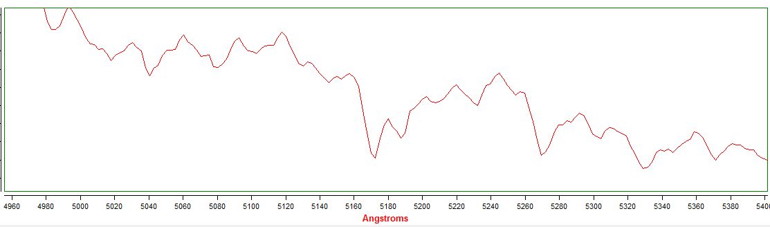

Hello, thanks for this exchange.
I am also a new user of Alpy and, after the usual presentation, this is my first message on this forum… For sure, it would be a great help to get some simple reference to quickly evaluate the tuning quality. Following Huge’ example above, this what I see on a sunlight spectrum (single image calibrated without instrumental response correction) around 5180A. Its looks not too bad but a quick PSF on the 5852A neon line shows a FWHM at 2 in bin2, still above the expected 1.5 value as described by François… The CCD is an Atik428 , same pixel size as Atik460. Good new, I still have plenty of room for improvement ! Thank again for these images.
Daniel
Daniel
- sunlight around 5180A
- Sun Alpy600 Atik428 dd080816.jpg (36.6 KiB) Viewed 7116 times
