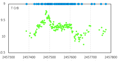

We report the results from two Swift XRT/UVOT observations of the recurrent novae T CrB, performed on 01/18/2017 and 01/29/2017. In April 2016, T CrB reached the peak of an optical brightening event (Delta V~1, Delta
B~1.5)
that started at the beginning of 2015 (Munari et al. 2016) and is slowly declining toward the quiescence level of V~10. A similar brightening event of unknown origin was also observed around 8 years before the nova eruptions of 1866 and 1946, when T CrB brightened up to V~3 (Schaefer 2014). Using the BAT transient monitor, we have made the surprising discovery that T CrB has undergone a shallow decline in its hard X-ray flux starting at roughly the time of the optical peak in April 2016. For the past 200 days, T CrB has been undetected by the Swift BAT Daily Monitor.

T CrB is one the few (4) recurrent symbiotic nova (1866-1946)
A new nova outburst is expected in the next months/years
T CrB produced a visual outburst at mag V ~ 9.2 in 2016
We have a good coverage of the event with 124 spectra in 2015-2016
Further observations are strongly encouraged at the better cadency as possible (T CrB is also one of the few symbiotics flickering at a short time scale)
