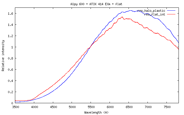

The most relevant comparisons I'd recommend:
This is a global view how the internal vs halogen lamps work.

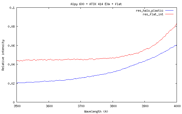

Which tells me that the Alpy internal lamp has a settle curve ending around 3700-3800A - the straight line below is mapped to the overall background level.
Also be aware that in 2D, the internal lamp has reflections < 3500A but it's less important- mentioning in contrast to the external Halogen which is free of reflections (so it's not the reflecting image what is mapped below 3700A).
I estimate the external halogen could be used till perhaps 3550A if done many or via noise filter.
Let me also point out that my T-Shirt + halogen seem to have a hard cut somewhere between 4000-4100A.

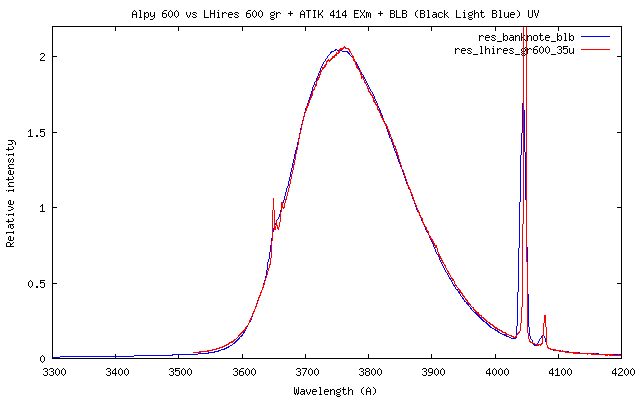

Just for fullness, efficiency comparison in UV with my earlier made LHires + 600/mm grating:
As you see, the the "BLB" lamp still produces well captured signal down to like 3500-3550A, with a similar efficiency curve in case of both instruments.
Hope this helps others working with the Alpy when considering a good extraction of the IR curve to the UV extent.
