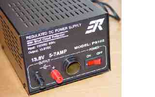

Thanks Peter! After I wrote my post, I thought of using 1 of my 2 12-volt DC regulated
PSU boxes; see http://img.diytrade.com/smimg/116833/27 ... Y/8d97.jpg
This seems like overkill, and the rating for mine is 5 amps, so I'm afraid it may be
too much for the Atik 460ex to handle (1 amp?). This PSU didn't seem to hurt my
SBIG STL-11K (or AP1200 mount), but those uses 5 amps, especially when its attached
to the AO-L unit which I always have connected.
