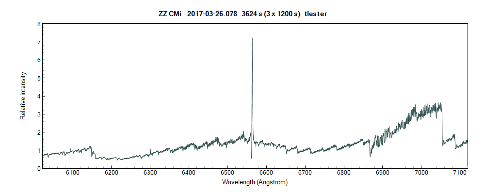

My spectra from last night is showing that the Ha line has developed a p cygni profile.
zzcmi_ 20170326_078_tlester.png (27.75 KiB) Viewed 4411 times

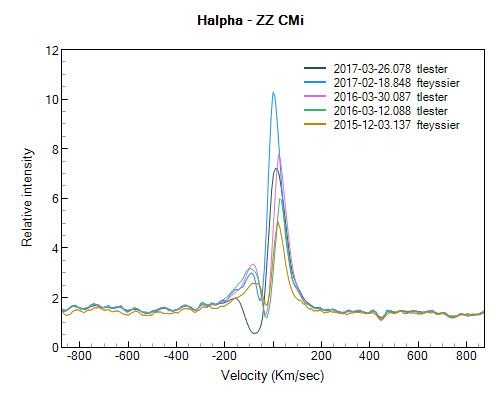

Compared to the last 4 high resolution spectra in the database:
zzcmi_ 20170326_078_tlester_Ha.png (24.3 KiB) Viewed 4411 times
Re: ZZ CMi showing p Cygni profile
Nice!
Significant variation in about 1 month
It could be the result of the decrease of the main emission component, more than a typical P Cygni profile
Further observations should be welcome to observe the varition according to the phase
