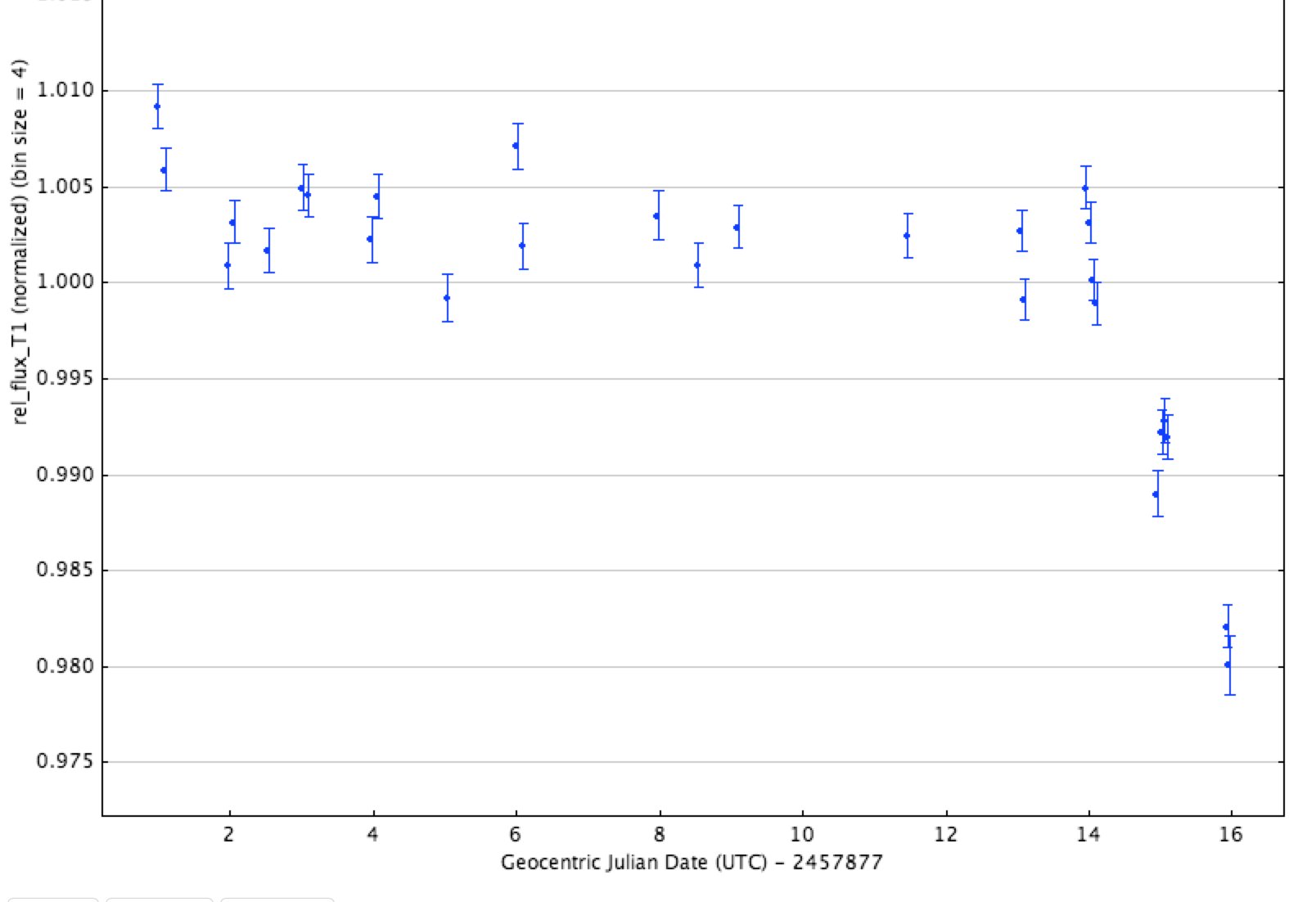

Tabetha Boyajian twitted 3 hours ago that the star is dipping right now.
Should observe now !

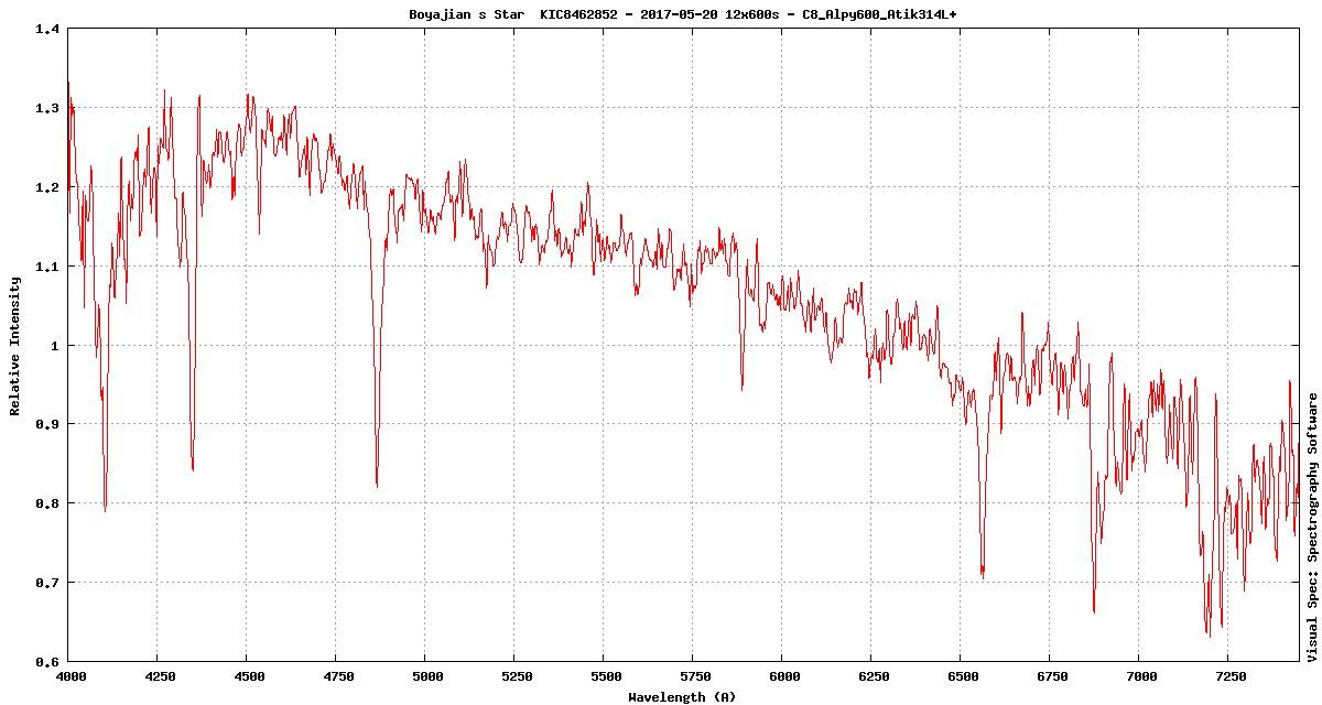

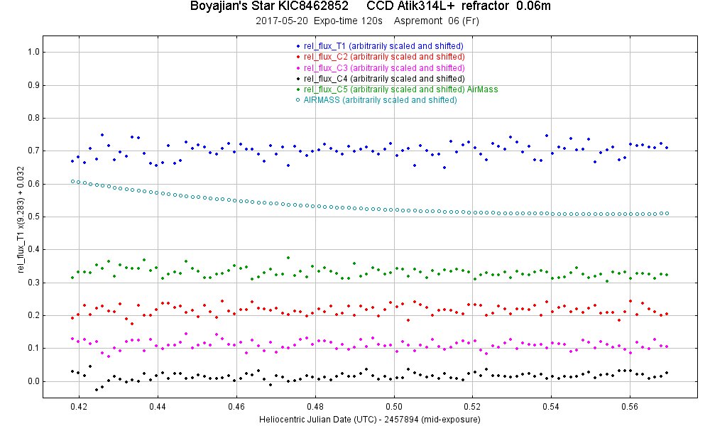

Here is a simultaneous photometric and spectroscopic observation of the KIC star in the night from Saturday to Sunday.
Spectre
Spectre
kic8462852_20170520_914_pierre dubreuil.jpg (145.17 KiB) Viewed 6447 times
Courbe de lumiere
Courbe de lumiere
Spectrograph Alpy 600, SC C8, atik 314l +
Photometry, guide refractor 60x400, atik 314l +
For the fun !
