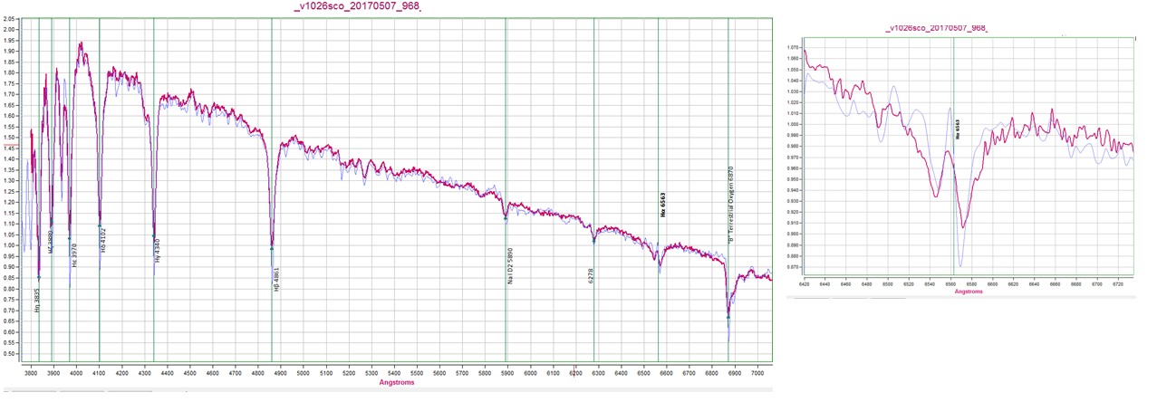

Because of very poor weather condition we only had one good night for observation. Our work has been focused on Be stars to facilitate comparison with reference results already stored in the BESS data base.
As a first example , the graph below shows our result on V1026 Sco (A8Ve / mv8.8 / 23° above horizon at time of observation). The reference (blue curve) is from C.Buil /Alpy600+Atik460 (only Bess low resolution data available in the data base for this star : _v1026sco_20130420_055_cbuil). This reference has a better definition than our own result (at R370 estimated by Isis). A zoom on Halpha region provide a more detailed view. However, in overall, the use of that low cost Kepler corrector appears to be an acceptable alternative to the Paracorr.
Collaboration between T60 spectro teams is providing an excellent working place for progress..
Any question or comment is more than welcome.
