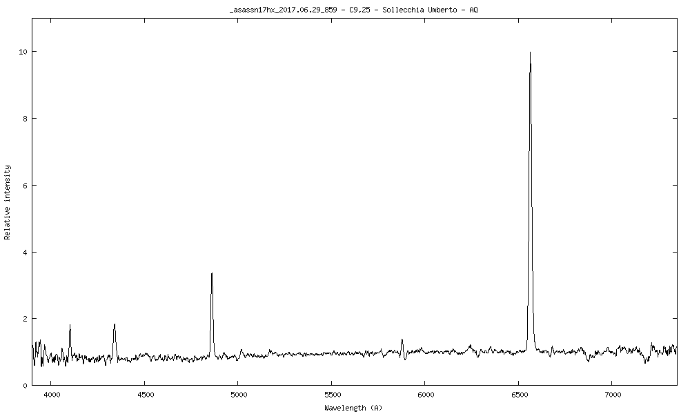

I just tried to observe it between two buildings (unfortunately I have some houses obstructing the horizon there) but a shower forced me to quickly close the observatory.
Only 50 sec exposure with a very strong turbulence. Anyway, the "super-noisy" profile shows a strong h-alpha emission line and weaker h-beta and h-gamma lines.
The nova is very bright. I measured an approximate unfiltered mag value of 11.3. Try to observe if you have a chance.

- Posts: 1562
Congratulations for the trial
It should decline fastly
- Posts: 1042
Good detection, for 50s it's a very good results.
- Posts: 248
Bonjour à tous, placez le profil de nova observée sur 29/06/2017 dans des conditions météorologiques non optimales.Umberto
- Posts: 731
Umberto e Paolo,
You have done a good detection job, congratulations!
Un abbraccio, Joan.
Un abbraccio, Joan.
- Posts: 248
Un grand merci Joan, un accueil chaleureux .Umberto

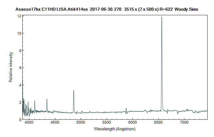

Greetings!
I had pretty good conditions tonight and I was able to capture 7x500sec of asassn17hx data with a C11HD with LISA and an Atik414ex. I used HD204754 as a Reference star.

- Posts: 577
Thank you all for your comments! Umberto, Woody, very nice spectra (LISA spectrum is fantastic). Joan, I think you could try with your echelle spectrographs. As soon as you can because the nova is now very bright (François tell us that it should fade quickly).
Yesterday many clouds were passing in the sky during the observation (as for Umberto, we live in the same city). Simultaneous photometry returned V mag 11.43 (average value).
I tried the line identification (some lines are discribed in the related ATels). The three weak emission lines with question mark resemble to me the Fe II multiplet 42 (hybrid nova?) but there are other possibile lines:
1) He I 4922 and/or Fe II 4924 (42)
2) He I 5016 and/or Fe II 5018 (42)
3) Mg I 5178 and/or Fe II 5169 (42)
What do you think?
What do you think?
