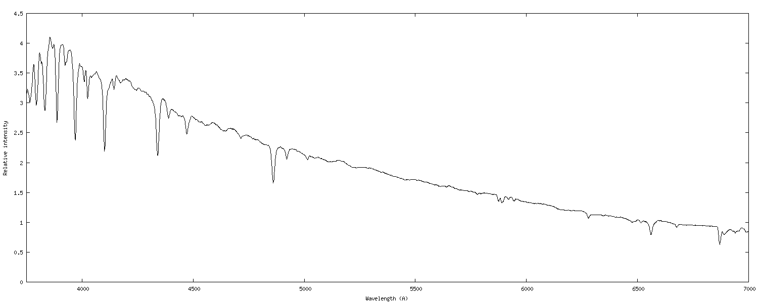

Hello all!
In the night of july 15 we have made a spectra of NW Ser
Lisa + Atik 460 ex + T 600 of "Mars" (the town in France, Ardèche)
Here is the picture of this spectra:
If it can help
Daniel for the club astro de Mars.
